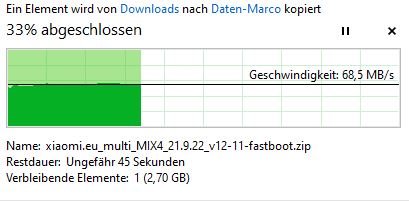

Hello, since a couple of weeks i am noticing a considerable performance degrate when writing to my UnRAID server.
Max transfer speeds went down from a steady 100-110 MBytes/s to 60-70 MBytes/s even on cached directories.

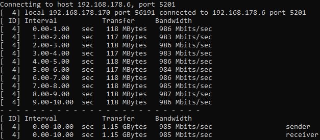

I started with a simple iPerf test:
Looks completely fine to me.

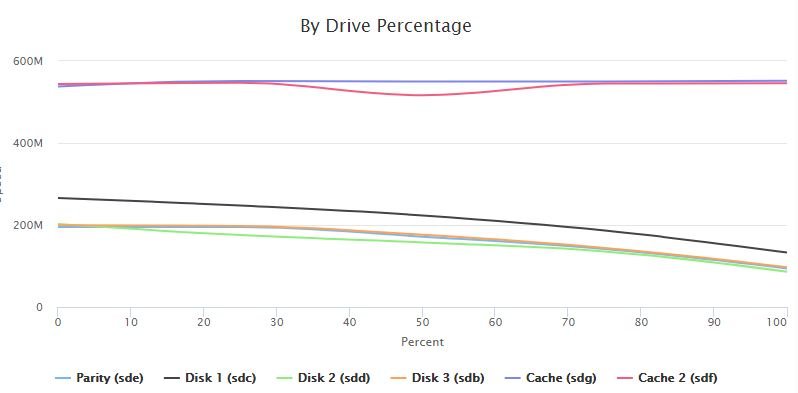

I then went through and did a quick disk speed test.
Also no cpmplains from my side.

Is the issue only upload or also download? Did you ran iperf the other way?
