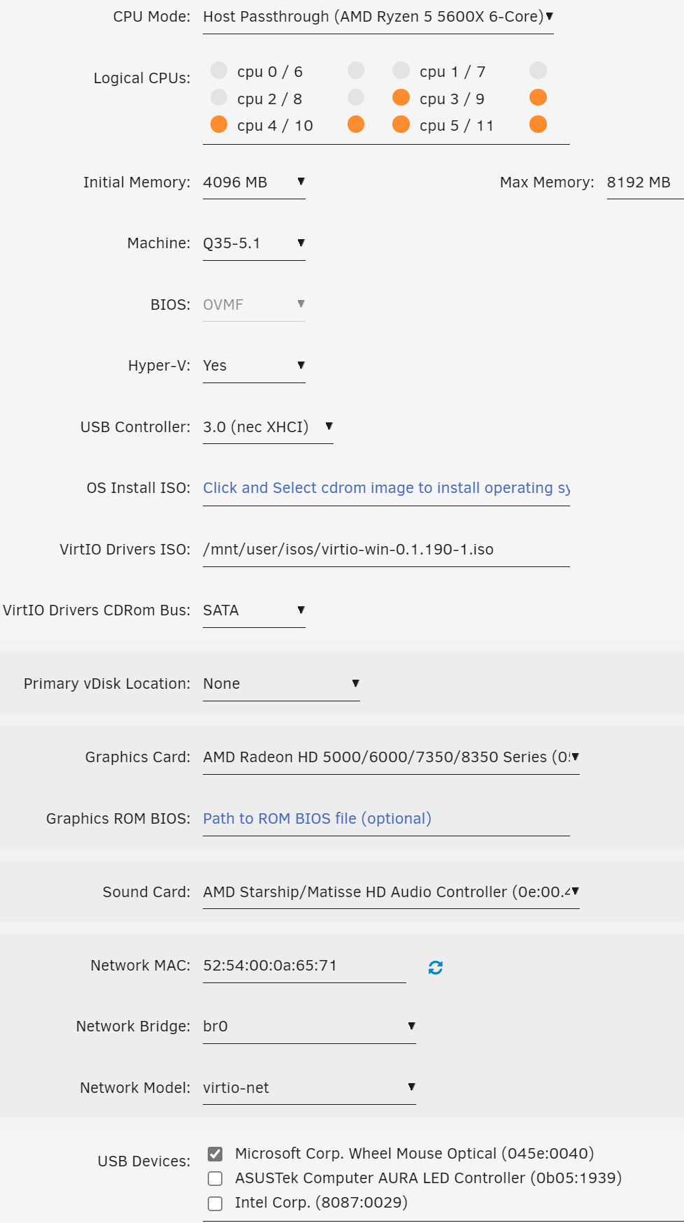

That does not work anymore with the current version (6.9.2).  The setting were a bit tricky to get through due to changes between the video version and the one I'm using - but the real problem might be that the UUID I grabbed from my Windows machine (using wmic csproduct get UUID), seems to raise an error in UNRAID:
VM Creation Error
error: Failed to attach device from /tmp/hotattach.tmp error: internal error: cannot parse product 0x1939#remove , error: Failed to attach device from /tmp/hotattach.tmp error: internal error: cannot parse product 0x1939#remove error: Failed to attach device from /tmp/hotattach.tmp error: internal error: cannot parse product 0x0029#remove

My current template looks like this:
It seems this has nothing to do with the uuid.
from your screenshot 0x1939 is the aura led controller and 0x0029 is intel and it's these that are causing issues, something like they cannot be detected to not being attached to the vm.
I would check the content of /tmp/hotattach.tmp file (if it's there), maybe it's a corrupted leftover

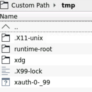

Not sure where that file is.  I used Krusader to look at the tmp directory:
It does not exist.  I'm confused.  I did not check to use the led controller in the VM.  Why would it attempt to parse it?

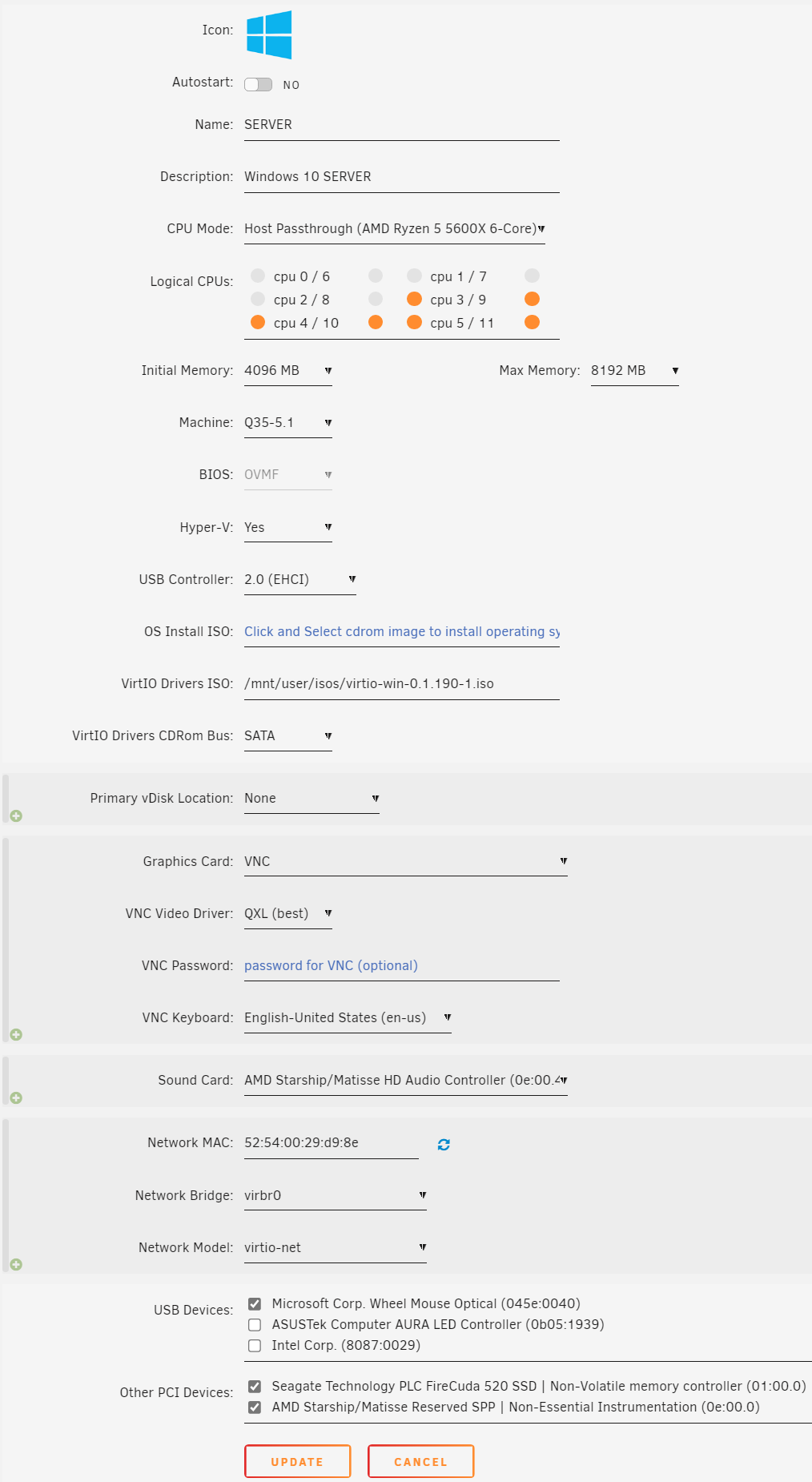

I ended up removing that VM and started from scratch.  Here are my current settings:
VM:
most probably it's a temp file created by qemu or libvirt; I should have looked at it when trying to start the vm.
