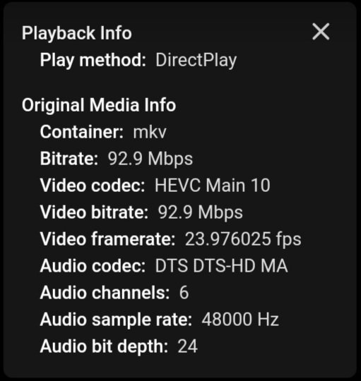

My issue is whenever I try to "direct play" 4K files via Emby/Unraid, some work but most of the time they buffer/stutter and some even display no image. The video bitrate averages between 75-100mbps for the movies.
