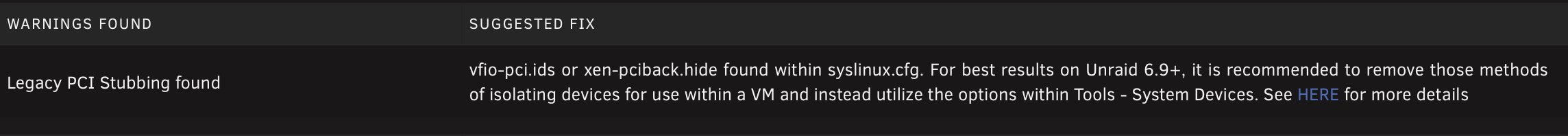

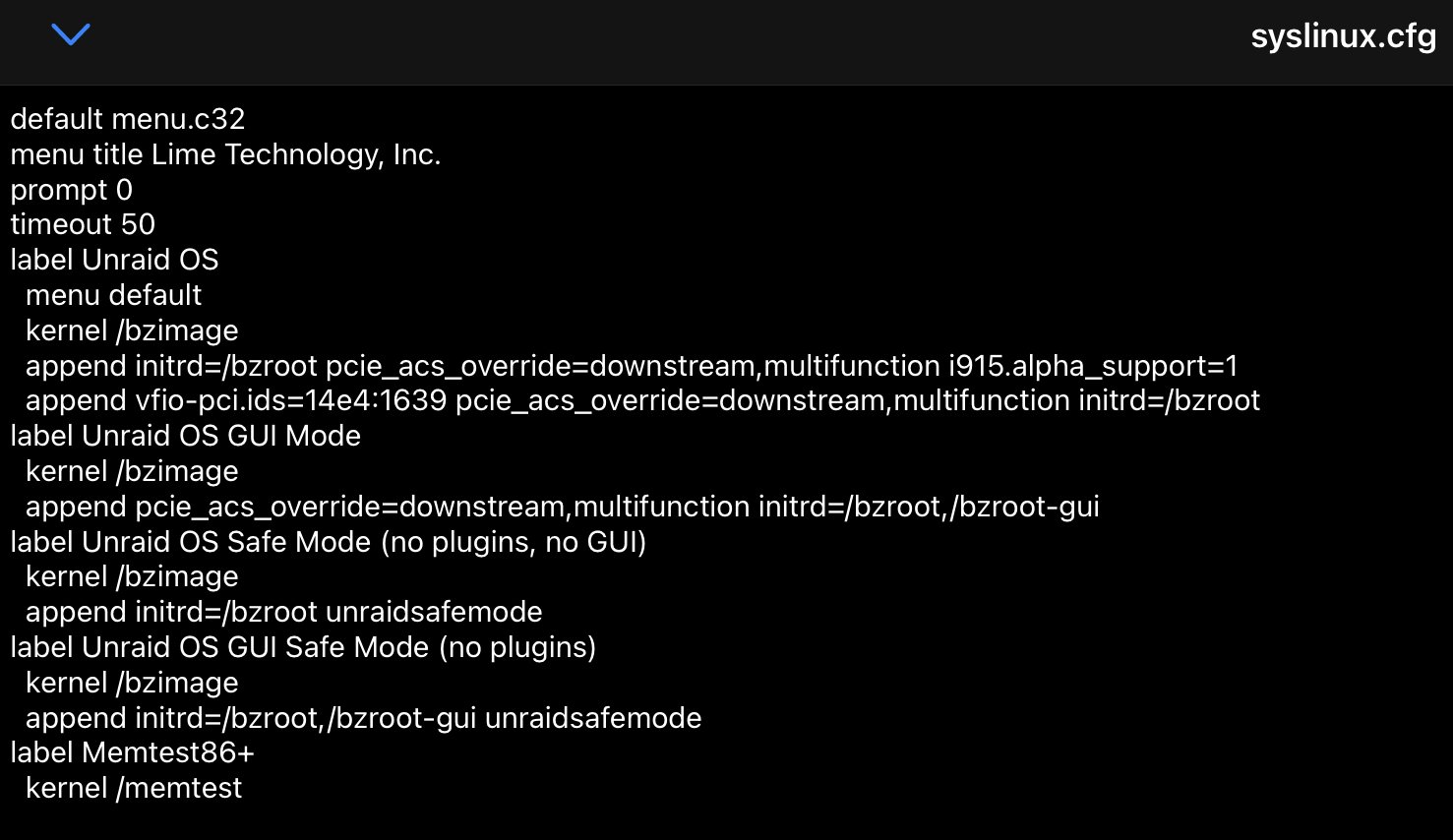

Trying to clear out all my warnings found on fix common problems. I have one left listed below. It has been quite some time since I set up this server. I am not sure how to edit the sysconfig file below to fix this error. I tried to edit the syslinux.cig to remove the append vfio which i think is causing the issue and the server would no longer boot. Any help would be awesome!
C7E8B105-27D9-4942-AC67-068F29081C4B.thumb.jpeg.322fb51ae7bd7fc52bdd3976ebc6ba88.jpeg86B74F98-E6C5-4BE2-B28C-0256491FAEE0.thumb.jpeg.8f9c8bac54eb136a426cda241e07e010.jpeg
The only part you needed to remove was the vfio-pic.ids=....  You still need to keep the pcie_acs....
And additionally, you would have to go to tools - system devices to then stub the hardware properly
