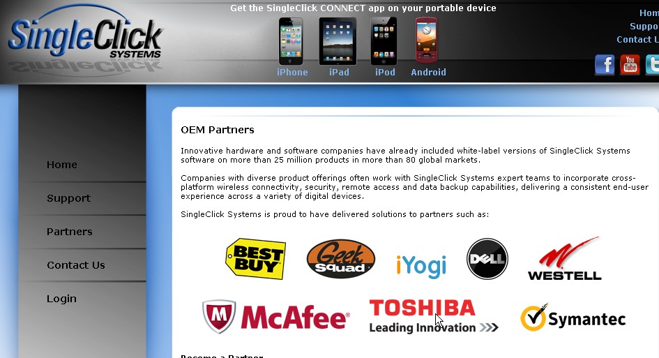

That is another machine on your LAN that is attempting to send a command to port 8080.  (And the command is not a "get" or a "post")
Joe L.
Hmm. Interesting, but definitely no Dells on my network. Only got Macs running 10.6.7, and a work Toshiba M-something or other laptop running Windows 7 Pro. Could this be the culprit?
Will check to see if anything else is trying to connect to port 8080, but I don't think so.
Andy.
It is more of a "singleclicksystems" networking solution/problem, which Toshiba happens to be an OEM partner (see attached)
