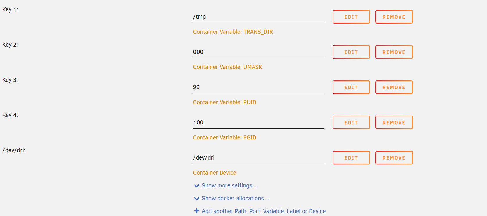

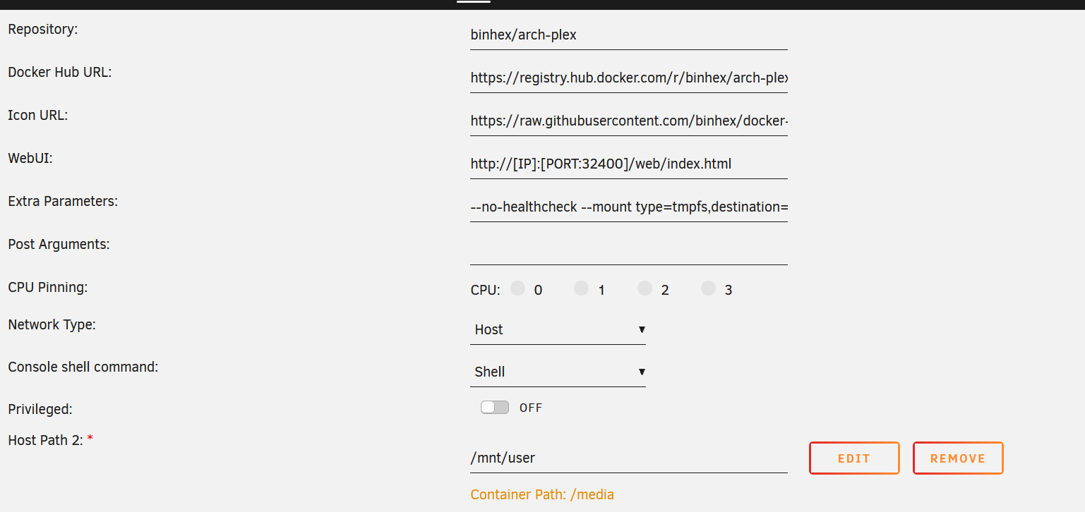

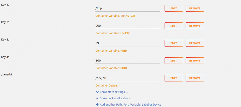

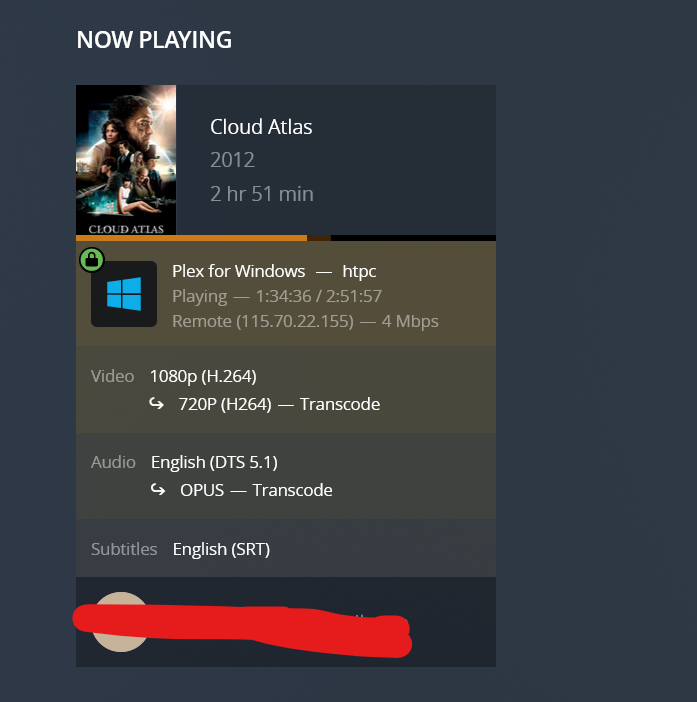

I have attached pics of the container settings and Plex Dashboard. The change in Plex is that transcoding is now being done in software, as the "hw" is no longer present on a stream. Prior to the install of the dGPU I have had binhex-plex running with QuickSync for months without any issues (so with the "hw" indicator present). This morning as a sanity check I unistalled the Nvidia driver and physically removed the dGPU, then did the Quicksync setup again as per the guide and it was all working pefectly in Plex once more. Then once the dGPU went back in and had the driver installed, Plex lost its "hw" transcoding again. The only other thing I can think to add is that I did run the unlock Nvidia GPU script once the drivers were installed - but not idea if that would contribute to the issue. Thanks again!
