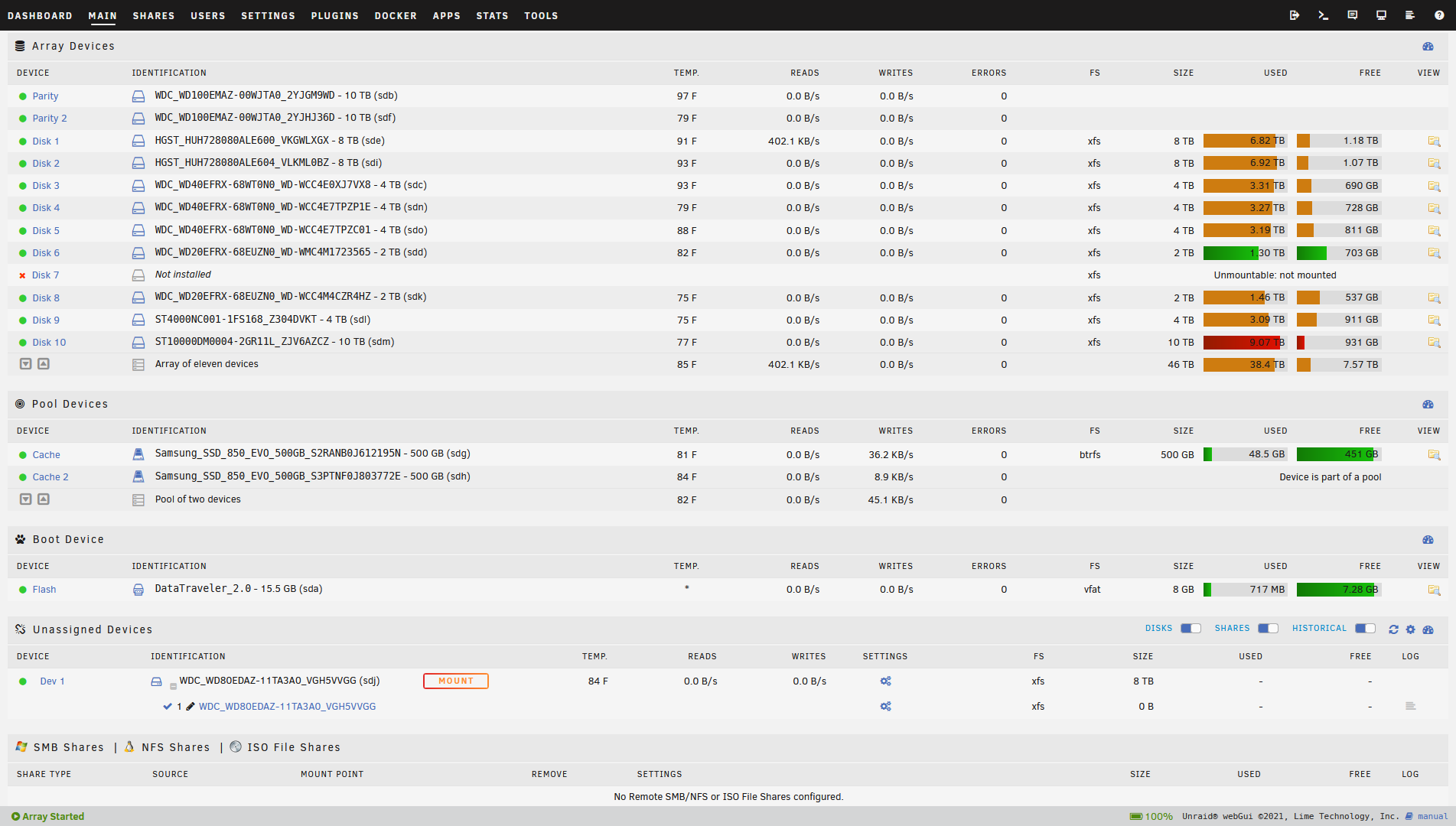

Trying to recover from bad power supply - one disk unmountable in array
Check filesystem on the emulated disk7, actual disk appears to have a power/connection problem, check/replace cables.

I don't know what I'm doing wrong, but I started the array in maintenance mode, changed the options to -nv as recommended, clicked check, and after hours refreshing the page it still looks like nothing is happening. How do I check to see if the check button actually started anything?
