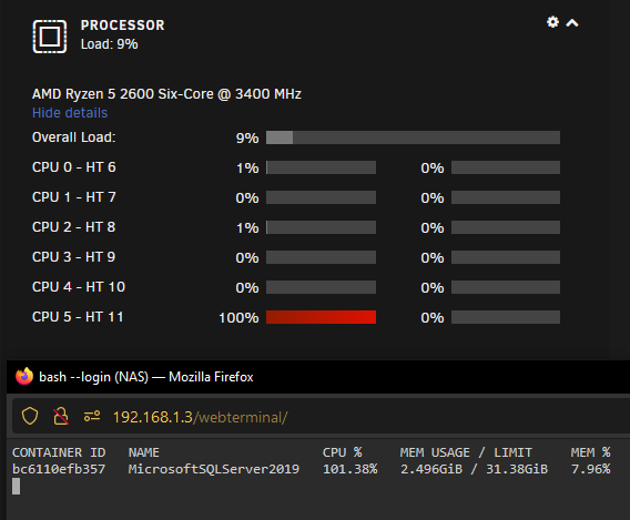

I have a running SQL Server in a container. I am currently running a fairly intensive process within SQL.  I would expect the CPU of the container to be near 100%.  My problem is that it appears to only be using one core of the host at a time.
I have edited the CPU pinning within the Docker Config (tried All On,  All On except 0,1), but get the same result.  To be clear, I want to allocate as much CPU to my SQL Server as possible.  The version of SQL server that I am using within the container does allow multi-core usage.

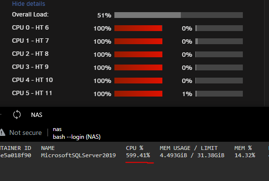

Thanks for the response @Squid.  Regarding the CPU Pinning, I tried every variation, all while have the VM service turned off.  I did figure it out though.
The SQL procedure that I was testing with was forcing a single thread.  Right now, I have the Docker pinned to the 6 cores (no HT) and I am running 6 instances of the SQL procedure.  As you can see in the image below, it is in fact properly using the pinned CPUs (always was).  It is odd that the docker stats command reports a sum of all cores on the CPU % though (this is what was throwing me off earlier).
Again, thank you for the response.
That % is actually quite normal.  By default (and convention in Linux), the percentages reported by each core are added up.   (Note that on the docker page itself (Advanced view), those percentages are normalized to be 0-100, so that page would be showing you 50% - although I can't remember if it takes into consideration the pinned cores or not so it might show 100%)
