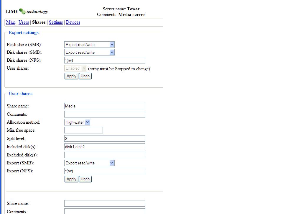

I seem to have difficult understanding user share setting.
Question 1 - is the setting of include disk correct ? ie  "disk1,disk2" is the correct entry in the include disk
Question 2 - if disk1 and disk2 is included, then should media folder be created in both disk1 and disk2 ?  current after I click on apply button , only disk 1 have media folder. disk2 is empty. is it correct? and what is it mean ? why ?
Qeustion3 - how to creat user share for dvd and bluray and any other folder after media folder. and it split level.

1. Yes but you can leave blank and all disks are used. You could just use exclude disk11 if that's the only one you do not want to use.
2. Perfectly normal. The share only gets created on disk2 when it's needed.
3. You want those folders go inside/under the Media share? You go to Windows Explorer, open the network, open Tower, open Media and then create the folders. These aren't shares, only Media is a share.
When you turn-on user shares they just appear on the network and they show the contents. There is nothing else you have to setup.
Peter
Your included disk settings (disk1,disk2) are correct.  A folder won't be created on disk2 until it is needed.  Since you are using the High Water disk allocation method, disk2 won't be used at all until disk1 is more than 50% full.  This is normal.  If you want disk2 to be used immediately, then use the 'Most Free' disk allocation method.
Split level depends on how you organize your files.  I'm not very good at explaining it, the manuals probably do a better job than I would.
To create a new user share just enter a name in the next empty box (under your 'media' share) and click 'apply'.  You can call a user share DVD, BluRay, or whatever you want.  You can leave the split level blank for now and figure it out later.
