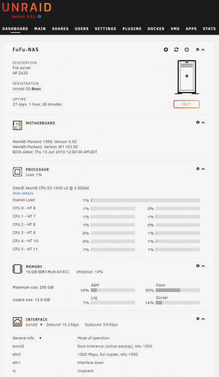

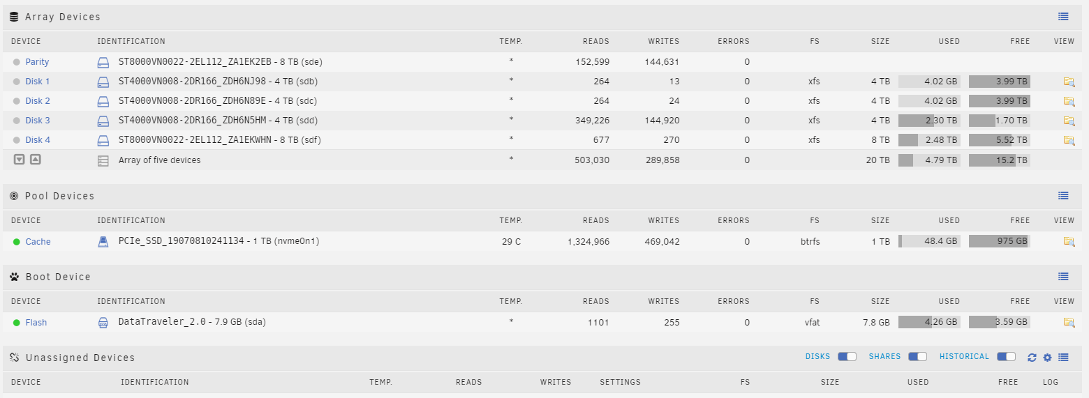

I am kinda rookie here and have been running my Unraid based NAS server on an old HP workstation for 2 years only following YouTube tutorials with no issues so far. Works really nice and I love it. Happens that I just got a newer and silent HP workstation with lots of memory and I would like to run my NAS server on it...  Can I just remove all my disks and my licensed Unraid flash drive and fire them up in a different hardware and system will come up exactly as it was previously? I am just trying to avoid backing up the my disk array (20 TB) which I won't have storage to allocate that much data.  Thank you anyways for any hints or help on this... it will be really appreciated.
image.thumb.png.9014a331285dd10372da17b715fc0b11.pngimage.thumb.png.3ba675df9c92753b37c2992748714ca3.png

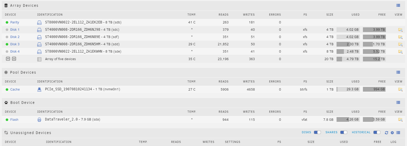

Works like a charm !  :D

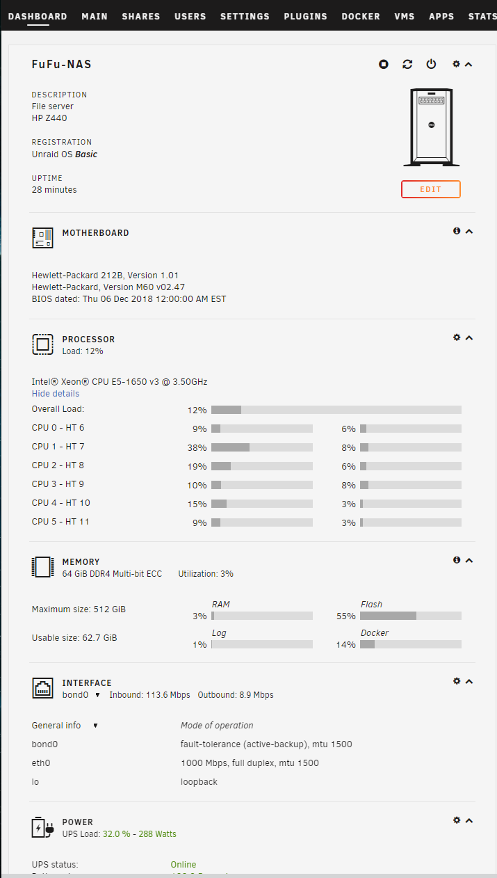

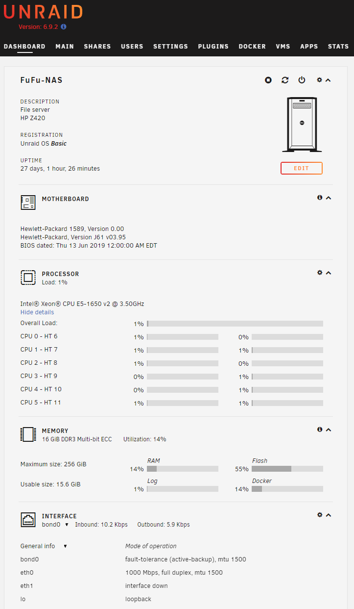

image.thumb.png.7bb02fd364dd6c7503ccabee7f394b4b.pngimage.thumb.png.5463bfe6fd958c3348f1c809a392d761.png
