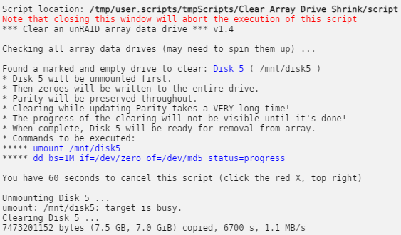

I thought I could get an ETA if I entered the following in the console:
dd bs=1M if=/dev/zero of=/dev/md5 status=progress
I have however found out that this also starts a clear disk process.
I therefore believe I have 2x processes running.
Here is my terminal:
Can I somehow stop one of the processes to get back on track?

I just tried to stop the array to rebuild the parity instead.
I can however not stop it, I assume, because the clear scripts are running.
Any idea how I stop the scripts or stop the array?
If the console is still showing the running command CTRL-C should stop it.
