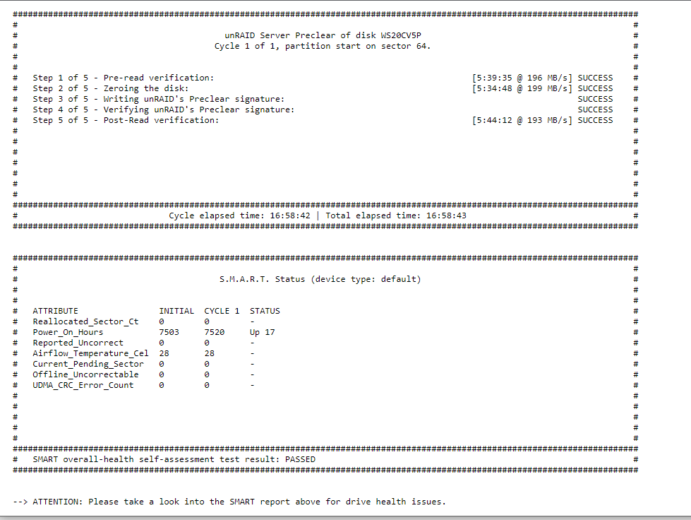

In the mean time, I added the "faulty" drive back into the array, and did a preclear, assuming if anything was wrong, it would show up. But.... It was all clear, and smart test was "Passed"

Attached: Preclear results.

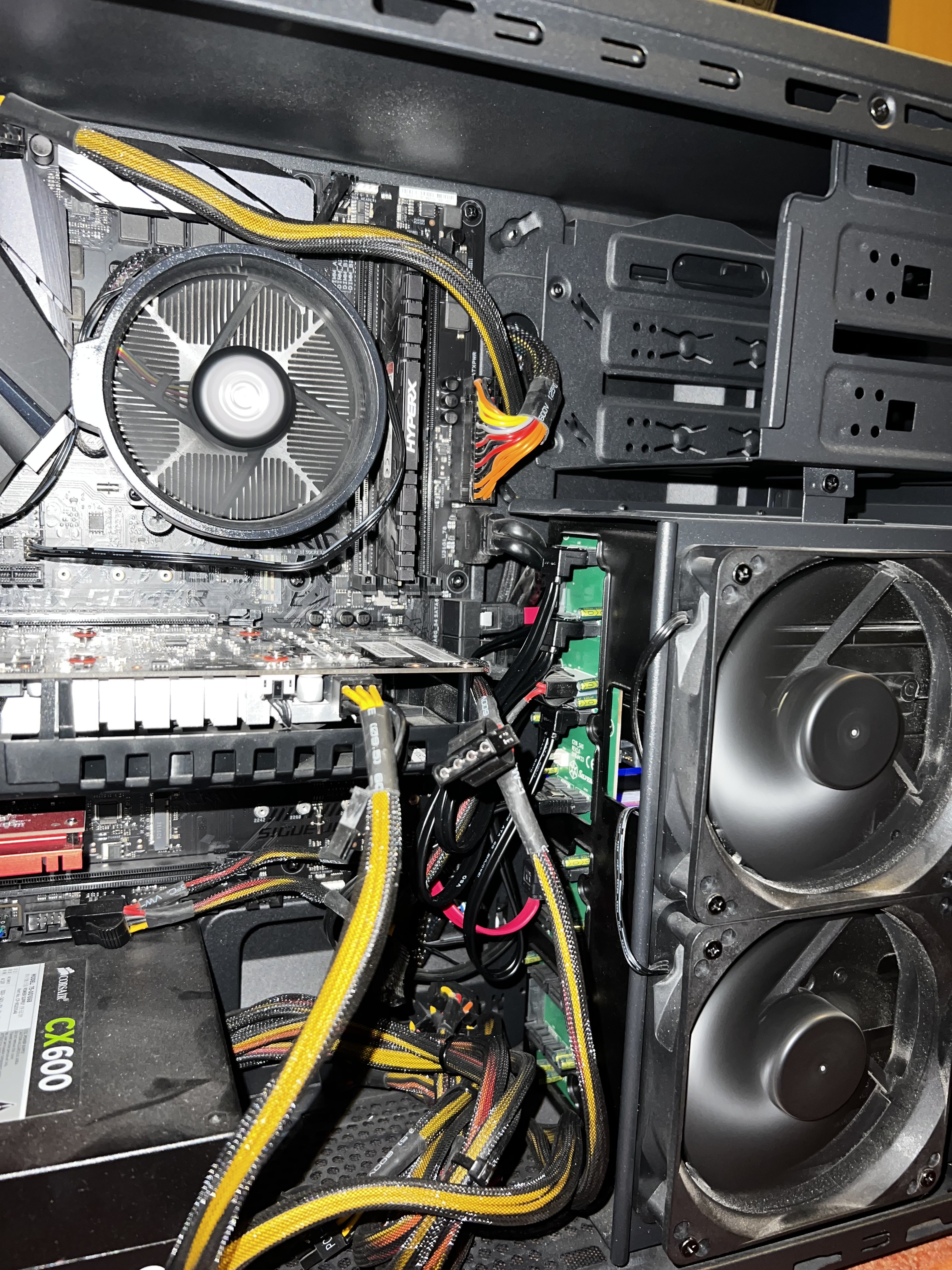

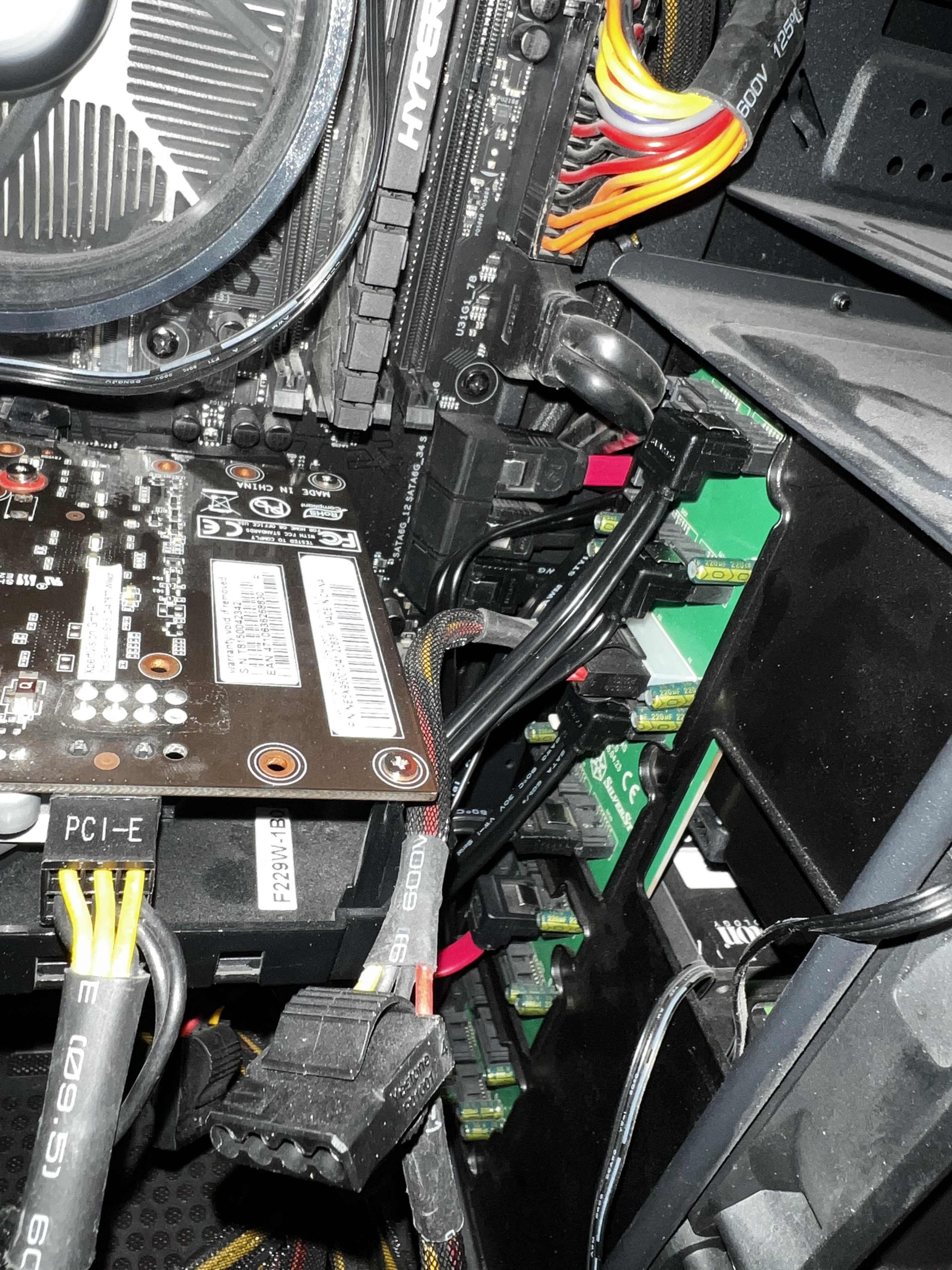

im not sure the cabling setup I have is quite the recommended one! Pictures attached.

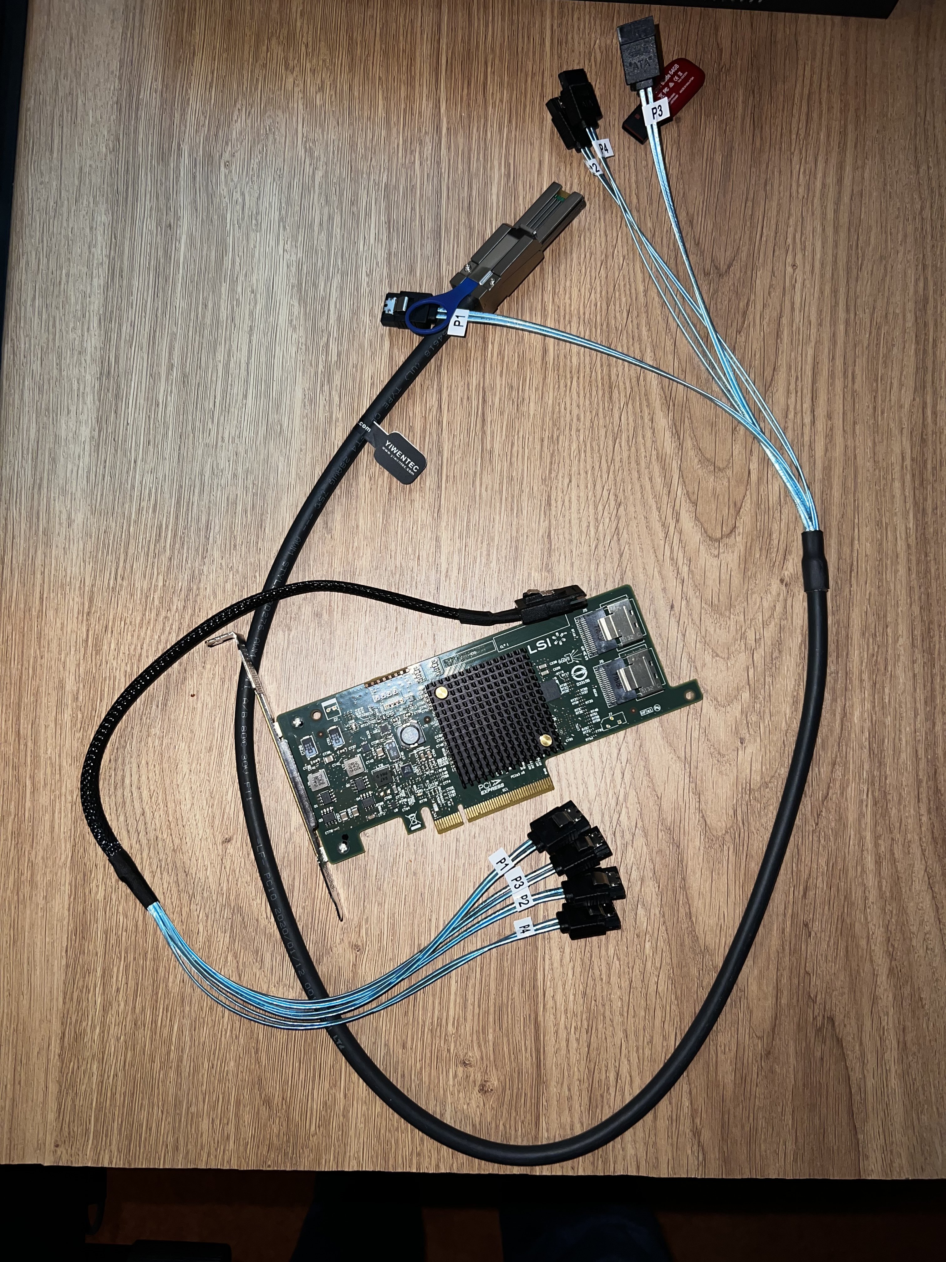

when I first built this server I bought a LSI card, I don’t have any experience with these and hadn’t really a clue how to use it, but I couldn’t fathom it and left it. Would this improve my system reliability?
also attached a picture of LSI card and cabling I bought.
