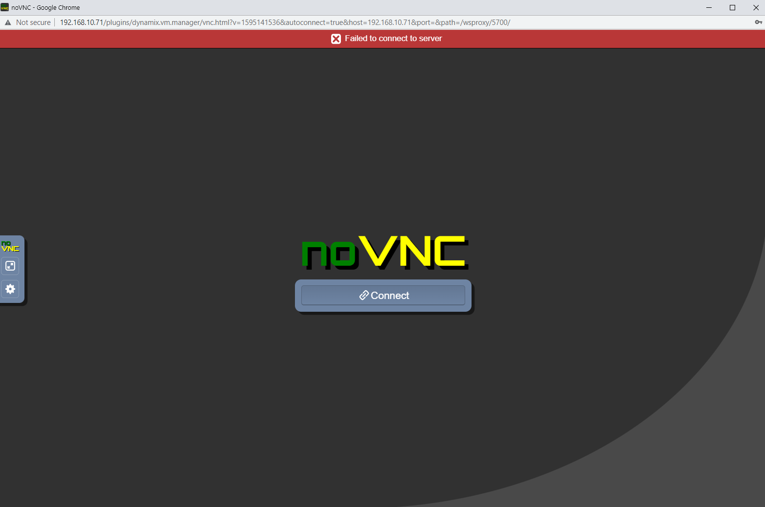

Here is a screenshot. When I press the "Connect" button I get the "Failed to connect..." on top.
I can't seem to resolve this problem whatever I do. The connection always fails as Windows (either 7 or 10) starts.
I've tried logging on from another PC but the same problem persists, so not a browser issue.

24 minutes ago, Squid said:
Are you sure the VM is still running? (VM tab)
Thanks. I didn't think to consider this. But indeed yes, the VM stops running at the same time the signal is lost.
So the problem is to do with something else. I need to understand why the VM would be failing just as Windows loads.
It is stopped
