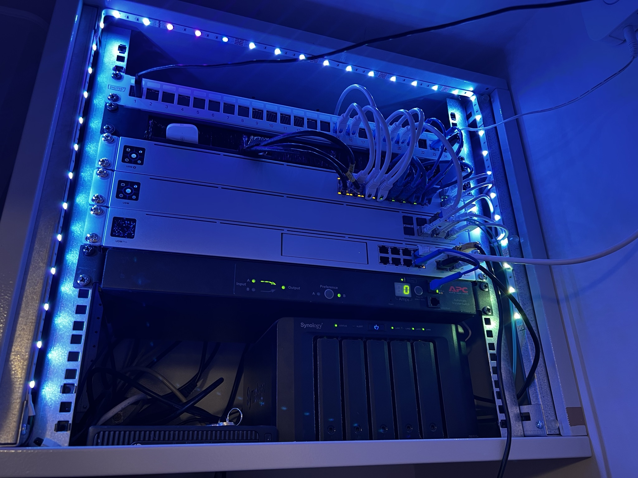

Puntoboy Posted January 31, 2022 Share Posted January 31, 2022 (edited) I'm planning a new server build to replace a Synology DS1515+. I already have another Unraid server I use for backing up the Synology. The problem is the network cabinet I would like to put it in only 300mm deep and I have 4U space, tops. I can't find a single case that fits into that requirement but I then spotted this disk enclosure from Silverstone which would fit inside the rack, but I'd need to pair it with another 1 or 2U device to run UnRaid etc. and a RAID card to connect to the mini SAS ports. Ideally with two hot swap bays for SSDs. https://www.silverstonetek.com/product.php?pid=483&area=en However, this enclosure seems hard to get hold of. Maybe I can cut the drive bays off of a 3U server with a SAS expander backplane instead? My requirements for my new NAS are: As many hot swap bays as possible (8 minimum). I have 5 x 14TB drives I need to migrate from my Synology - I have a backup Plex Media Server and storage Sonarr/Radarr/NZBGet - Docker VMs Home Assistant host - Currently running on Proxmoxx (The HP Mini PC in the bottom of the rack) 10GBe NIC (SFP+ Ideally but RJ45 would be fine) I have a Mini-ITX motherboard (Asus ROG Strix X570-I Gaming) and a SFX-L PSU already so I could use those, but now I'm thinking another board might be better. Obviously the SFX PSU won't really fit into a 1 or 2U enclosure. If I can't find a solution, my final plan is a Supermicro SuperChassis 826E16-R920LPB as I can just about find space for it due to the height of it. But Ideally I'd like a solution that fits inside the rack. Edited January 31, 2022 by Puntoboy Quote Link to comment

Puntoboy Posted February 3, 2022 Author Share Posted February 3, 2022 Thanks, I looked at that one but it's too tall. I think my solution of a 1U server with a 3U JBOD array is the only option that will work. Quote Link to comment
te5s3rakt Posted March 3, 2022 Share Posted March 3, 2022 Did I post something and forgot? This is exactly my situation and setup, DS1019 though, but all the other hardware is identical, and I’ve been googling for a month trying to find a rack mount solution to upgrade my the Synology to. Was chasing something with 12 bays, and enough room inside for a mATX board, Xeon 10core CPU, 128GB RAM, and possible a GPU, something like a P2000 maybe. But that proved impossible. Literally impossible. So I thought about it more, and realised 8 bay would probably do. That’ll double my usable storage over the Synology, and that’ll be plenty to get me through the next couple years, at which point I planned to move house, where I’ll have more room to install a proper 600mm deep rack. Hasn’t improved things though. Still very tough. Closest I’ve found was a UNAS or Silverstone case. But case though, no rack mount. The UNAS might fight. Silverstone a bit tall. Utterly lost atm. So if you find a solution, I’d be keen. Quote Link to comment
