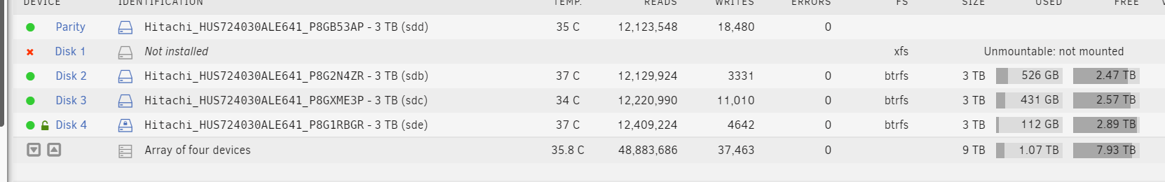

I removed a drive (a small 200gb) from the array. I followed the shrink procedures (https://wiki.unraid.net/Shrink_array), but my browser crashed and the 'write zero's' window died. I monitored top to see the activity and after a day, when the shfsd went away and writes to the parity were not moving, i removed the drive.
Now in my array config, i have slot 1 (where the 200gb) drive used to be is empty.

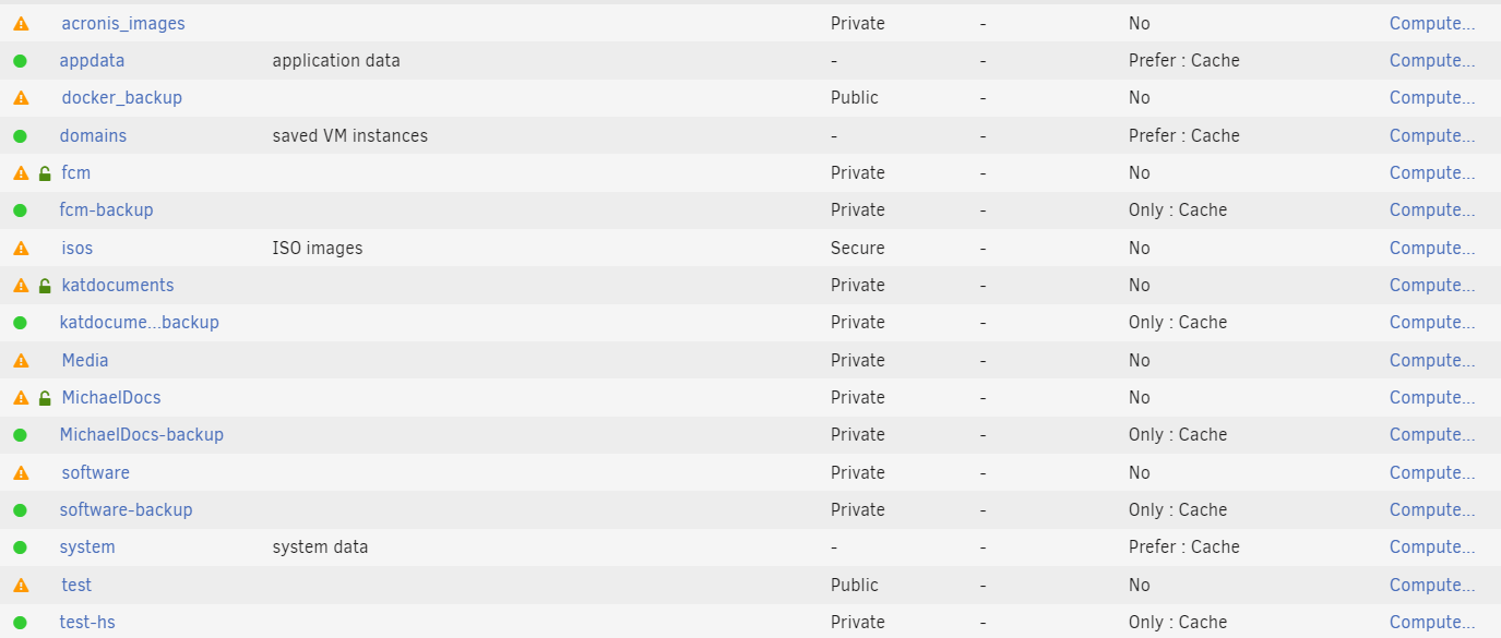

I think this is affecting my shares, as they show the yellow warning sign.  (ignore the -backups), i created those on the raid1 cache drive).

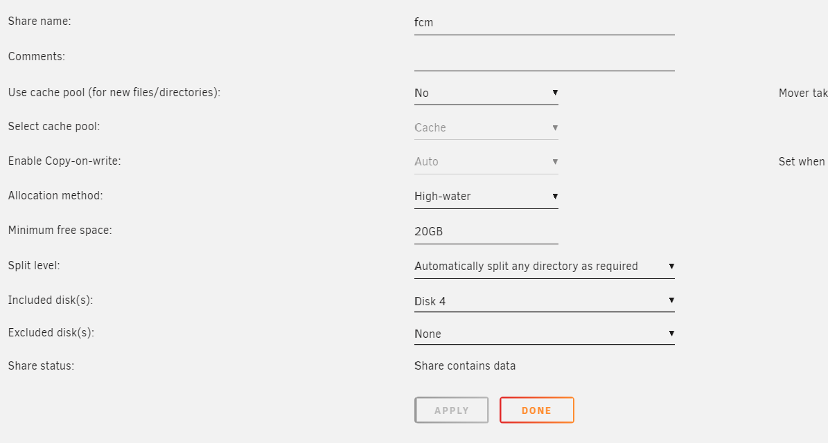

Looking at the FCM share, it is only on disk4, which is encrypted
I think the missing drive is making Unraid think that something is wrong and showing those shares as unprotected. A parity read overnight shows zero errors.

You need to do a new config without disk1 and re-sync parity, note that any data there will be gone, though it's unmountable anyway.

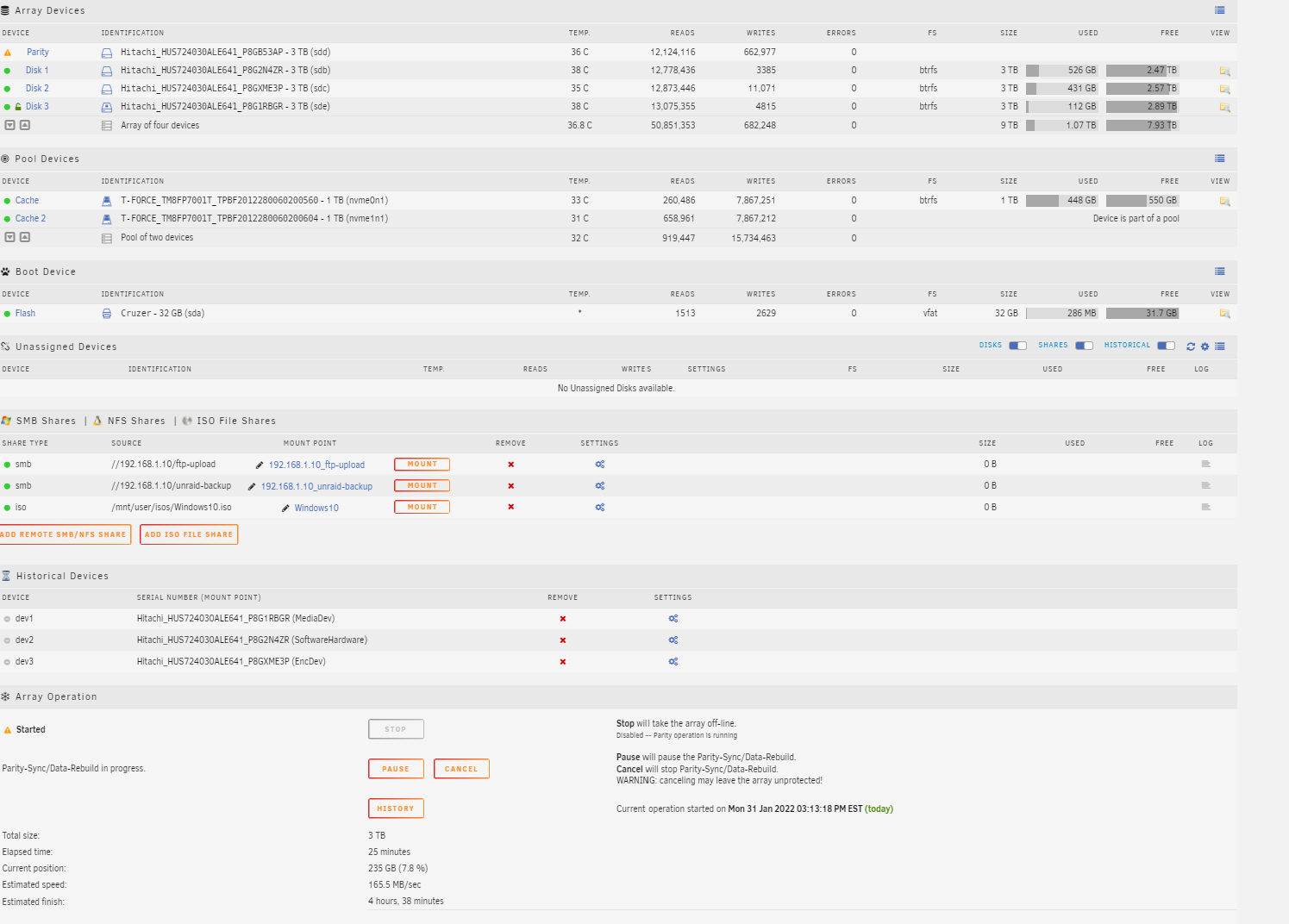

Thank you. It seems to be working great. No more failed drive listed, and the parity is running. I had to reset all my shares so they ended up on the correct drives as the drive assignments changes (which is what I wanted). I'm confident that after the parity check, all shares will show protected.

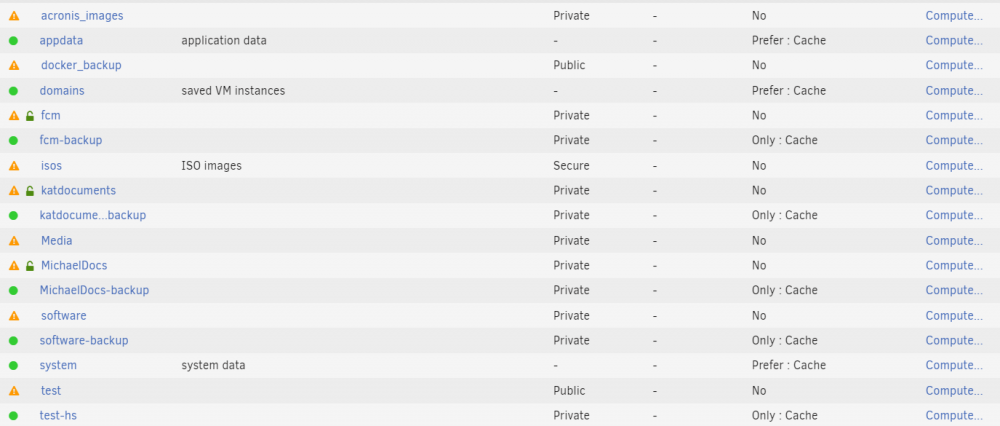

Thank you. It worked perfectly.  My shares are now all green, protected.
