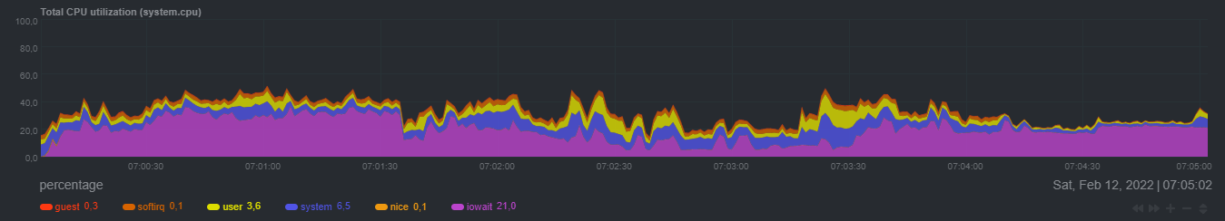

February 12, 20224 yr Author Progress I have made some progress on my issue. What helped was understanding what iowait means and how it occurs. It happens when something requires io of a disk while that disk is under full load by another process, causing it to wait. This gave me the idea to split my cache pool into two. One cache pool (a) is used for appdata / system / domains (vms) Other cache pool (b) is used for all shares that will eventually get moved to the array, such as plex media / downloads Doing this has fixed my issue of plex (or other containers) becoming unresponsive when media is downloaded, because it is a totally separate disk. Remaining issue While this has solved some issue's, I still have issues with the mover. When files are moved from the cache pool (b) to my array, reading anything from the array of the disk that data is being moved to just does not work until the mover is finished. I tried to fix this by changing the mover CPU & IO priority with my own plugin (CA Mover Tuning fork). This seemed to have helped a little bit, but after the mover finishes I notice high usage across my entire array (updating parity?) which still causes lock ups (cpu iowait) until that is finished, and this puts load on all disks. I have already tried both available md_write_method, reconstruct write (aka turbowrite) finishes the mover faster but the parity process after still causes issues.

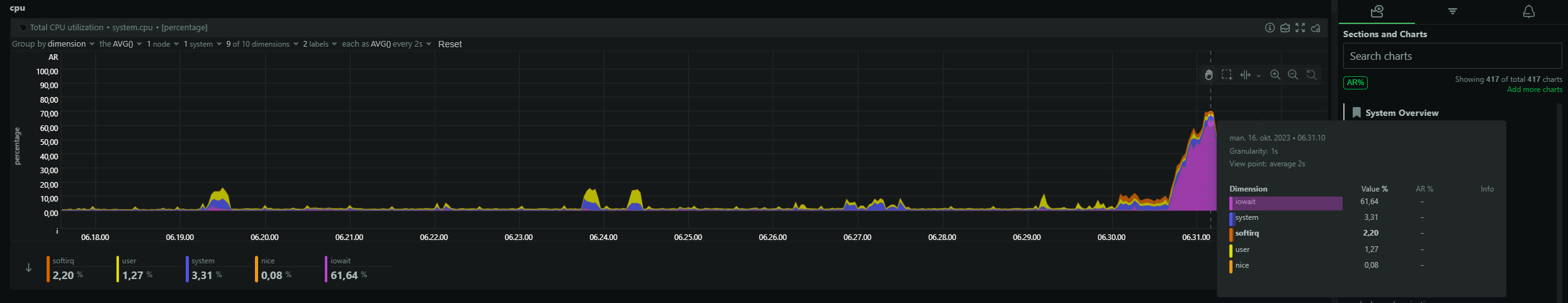

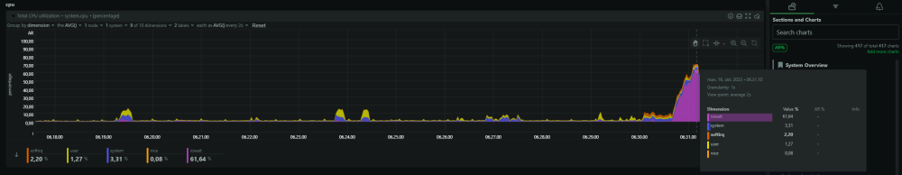

August 2, 20233 yr On 2/12/2022 at 3:45 PM, AeonLucid said: Progress I have made some progress on my issue. What helped was understanding what iowait means and how it occurs. It happens when something requires io of a disk while that disk is under full load by another process, causing it to wait. This gave me the idea to split my cache pool into two. One cache pool (a) is used for appdata / system / domains (vms) Other cache pool (b) is used for all shares that will eventually get moved to the array, such as plex media / downloads Doing this has fixed my issue of plex (or other containers) becoming unresponsive when media is downloaded, because it is a totally separate disk. Remaining issue While this has solved some issue's, I still have issues with the mover. When files are moved from the cache pool (b) to my array, reading anything from the array of the disk that data is being moved to just does not work until the mover is finished. I tried to fix this by changing the mover CPU & IO priority with my own plugin (CA Mover Tuning fork). This seemed to have helped a little bit, but after the mover finishes I notice high usage across my entire array (updating parity?) which still causes lock ups (cpu iowait) until that is finished, and this puts load on all disks. I have already tried both available md_write_method, reconstruct write (aka turbowrite) finishes the mover faster but the parity process after still causes issues. I got the almost the same setup as you but with 2 x Samsung 870 EVO. So when i download like 60mb/s my dockers get reallyslow. How can i see if this is the IOwait? So the only good solution is to totally seperate things? I dont understand this. With my old windows server 2012 r2 this was never a problem. Why cant i SSDs handle the smaal load?
October 5, 20233 yr On 8/2/2023 at 7:23 AM, DanielPT said: With my old windows server 2012 r2 this was never a problem. Why cant i SSDs handle the smaal load? This is essentially my question, too. I was running on a Windows box, had some docker problems, and moved to Unraid. I thought that since docker runs so much better in Linux than in Windows, performance would be better. But it's not, it's much worse. Basically any time any docker container or VM does something intensive, the whole box locks up and I can't even get the web GUI to respond, etc. until it's done. Frustrating.
October 16, 20233 yr Hmm i still suffer some when downloading. My appdata folder is exclusive access but i still have high Iowait Is the "real" solution to store download on another drive even that it is SSDs. ?
