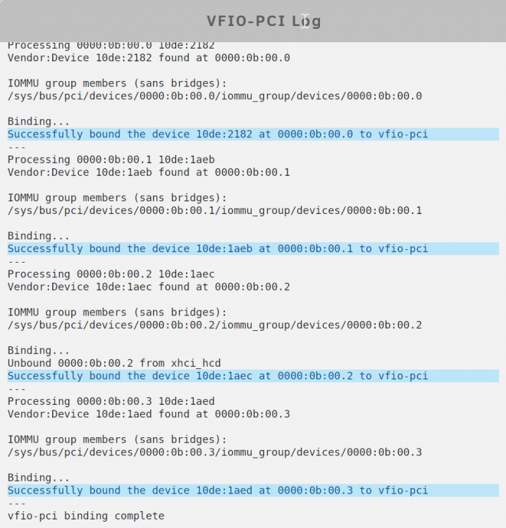

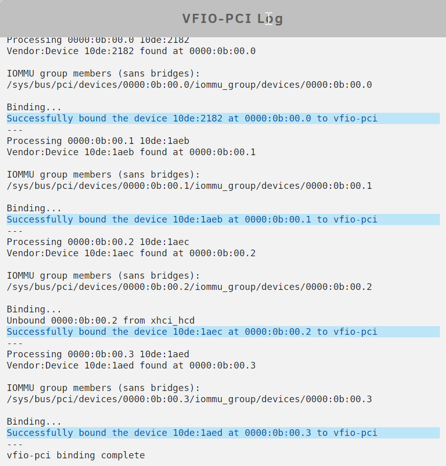

vfio: Cannot reset device 0000:0b:00.1, depends on group 31 which is not owned.
Even if in different iommu groups, maybe you need to attach to vfio also the usb controller at 0b:00.2 and the serial bus controller at 0b:00.3 of the gpu:
0b:00.2 USB controller [0c03]: NVIDIA Corporation TU116 USB 3.1 Host Controller [10de:1aec] (rev a1)
	Subsystem: NVIDIA Corporation Device [10de:2182]
	Kernel driver in use: xhci_hcd
0b:00.3 Serial bus controller [0c80]: NVIDIA Corporation TU116 USB Type-C UCSI Controller [10de:1aed] (rev a1)
Attach them to vfio and change in your ubuntu vm from this:
      <driver name='vfio'/>
      <source>
        <address domain='0x0000' bus='0x0b' slot='0x00' function='0x0'/>
      </source>
      <rom file='/mnt/user/isos/vbios/gtx1660ti.rom'/>
      <address type='pci' domain='0x0000' bus='0x03' slot='0x00' function='0x0'/>
    </hostdev>
      <source>
        <address domain='0x0000' bus='0x0b' slot='0x00' function='0x1'/>
      </source>
      <address type='pci' domain='0x0000' bus='0x04' slot='0x00' function='0x0'/>
    </hostdev>
to this:
      <source>
      </source>
      <address type='pci' domain='0x0000' bus='0x03' slot='0x00' function='0x0' multifunction='on'/>
    </hostdev>
      <source>
      </source>
      <address type='pci' domain='0x0000' bus='0x03' slot='0x00' function='0x1'/>
    </hostdev>
      <source>
        <address domain='0x0000' bus='0x0b' slot='0x00' function='0x2'/>
      </source>
      <address type='pci' domain='0x0000' bus='0x03' slot='0x00' function='0x2'/>
    </hostdev>
      <source>
        <address domain='0x0000' bus='0x0b' slot='0x00' function='0x3'/>
      </source>
      <address type='pci' domain='0x0000' bus='0x03' slot='0x00' function='0x3'/>
    </hostdev>
Reboot before running the ubuntu vm.

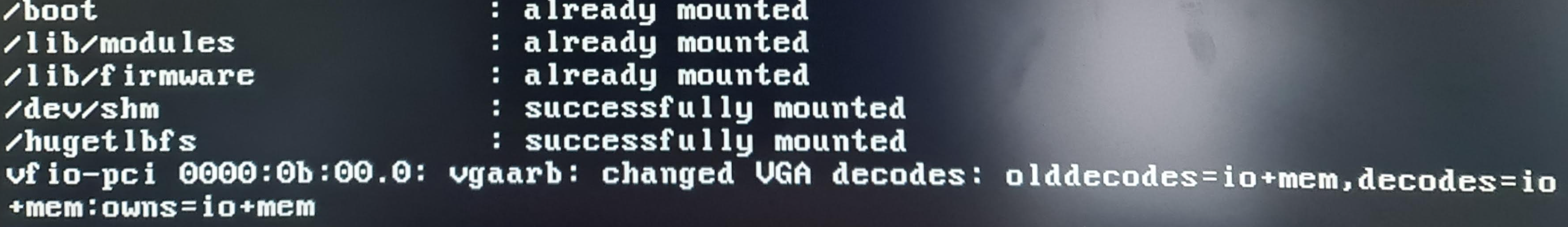

As far as I can see there are no more info in the logs, and all should be setup correctly, so no more ideas..
Check if the vm hangs at boot or if the vm is booting but you have only no video output, maybe an issue inside the vm (drivers)?
If I change any VMs to VNC they boot. It's only when I try and passthrough the GTX1660ti that I get 'No Signal Detected'
To add to this. I've discovered that the Ubuntu VM boots fine when passing through the GTX1660ti but there is no signal. I can RDP to the VM from another, so the VM appears to be fine.

31 minutes ago, Daryl Williams said:
04:00.0 Audio device: NVIDIA Corporation TU116 High Definition Audio Controller (rev a1)
05:00.0 USB controller: NVIDIA Corporation TU116 USB 3.1 Host Controller (rev a1) (prog-if 30 [XHCI])
07:00.0 Serial bus controller [0c80]: NVIDIA Corporation TU116 USB Type-C UCSI Controller (rev a1)
Sorry but something is wrong, either you are not applying my advices or for whatever reason your changes aren't applied, you can't have with the changes applied in the vm components of the gpu in different buses.
I've changed the XML as per your instructions on the VM, bound the devices in Tools>System devices and have changed the sysconfig in Flash> Unraid OS.
I just wanted to check that I'm applying correctly.
I have no doubts you have good intentions to fix it :)
However I cannot be of more help if buses are not fixed, because I don't know what to do in addition to give you the settings to set the gpu as multifunction :(
Have no idea why these settings aren't applied..
You were right. For some reason the settings did not save in the XML. I've managed to ensure that they are now saved. I've run the command from the RDP session and this is the output. I can't see a reference to NVIDIA.

I've bound the devices again for the device. It shows this in the vfio log.
I've noticed at boot it doesn't get to the login prompt when binding these devices. Is this normal?
It still doesn't passthrough. I've attached the latest diagnostics.
