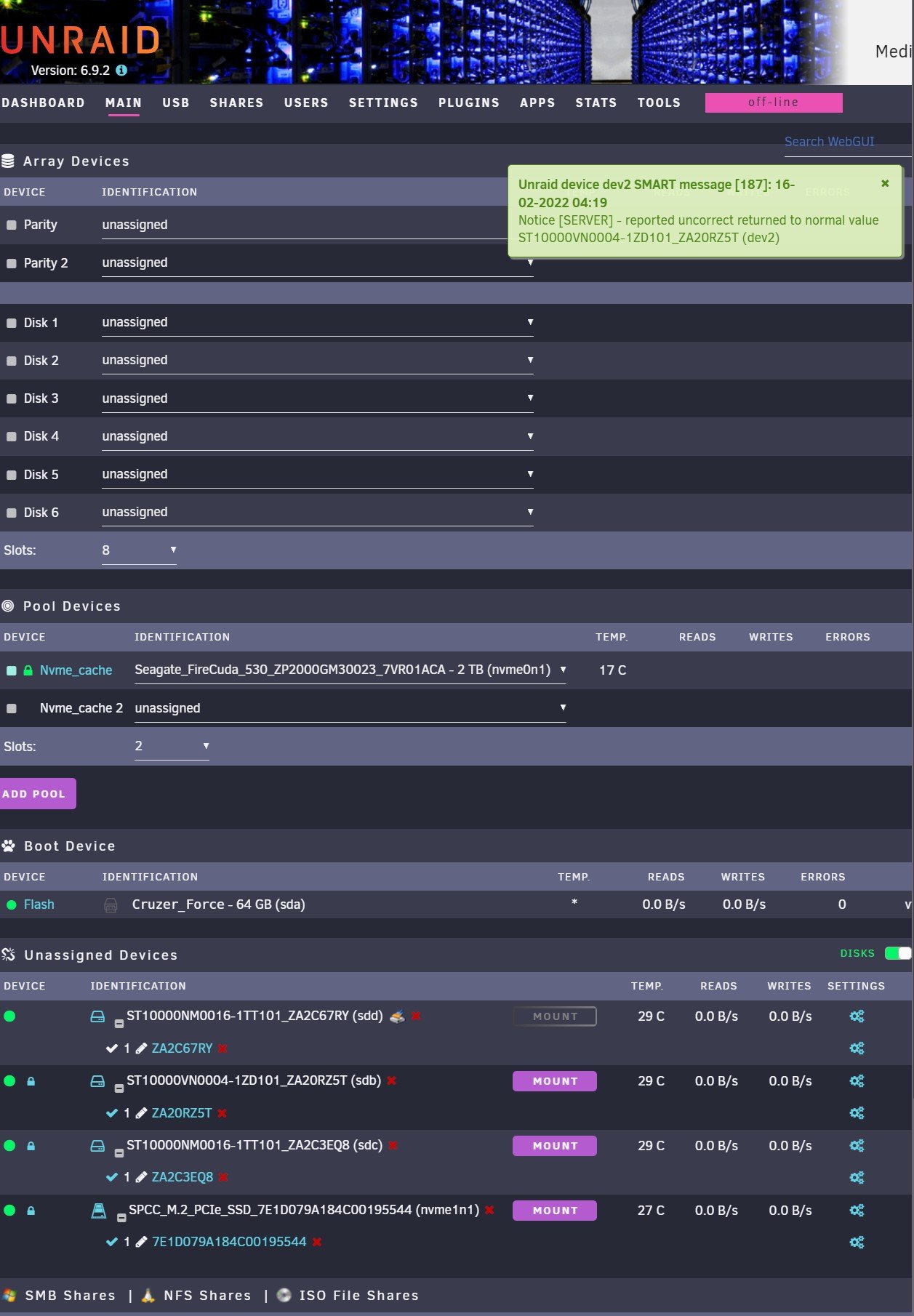

I ticked preserve current assignments : array slots before.
now my array drives are unassigned devices not like they were before but i have to reorder them and unraid wants to clear the parity drive. The problem i have 3 10 TV drives in there but i don't know which drive was disk 1 and disk 2 and the array drive . When i now reorder them not as they were before will i loose data ? What should i do know is there a way to see which drive was the parity ?

If you only had single parity drive, order doesn't matter. As long as you assign parity to the parity slot, and exactly the same, and only the same, array data disks to any array data slots, then parity is still valid and you can check the parity valid box and start the array.
Thanks yes only 1 parity drive but which one was it ? I posted a pic in the first post. is it the sdd ? because its unmountable ?
Correct. Parity has no filesystem so it is not a mountable disk.
5 minutes ago, xxsoulxx said:
is it the sdd ?
Take note of the serial numbers, not sd. Unraid keeps track of the assignments by serial number. The sd may change, especially if you add, remove, or change disks in the future.

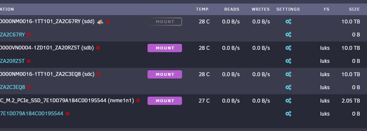

Thank you so much for the fast reply, i got a heart attack for a moment :D. Is this the best way to remove a cache pool drive or is there a better way ?
I will note the serial numbers once everything is running again i just want to check that sdd is the parity because its not mountable and no filesystem is showing.
And its normal that unraid wants to delete all data on the parity now ?
