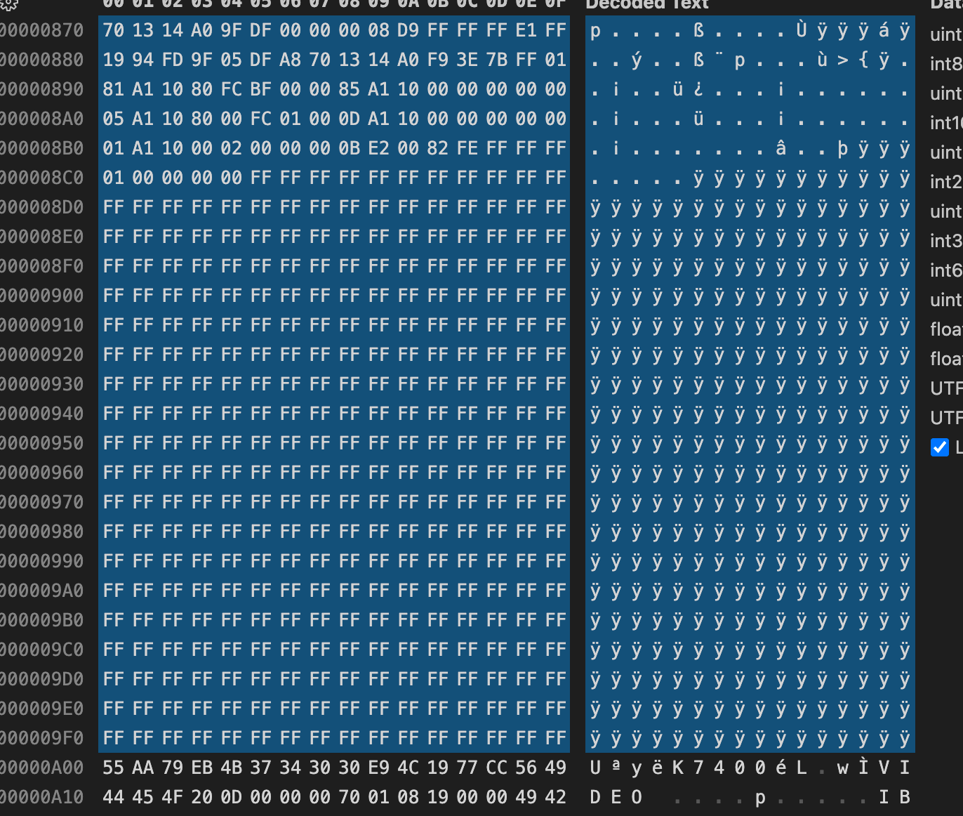

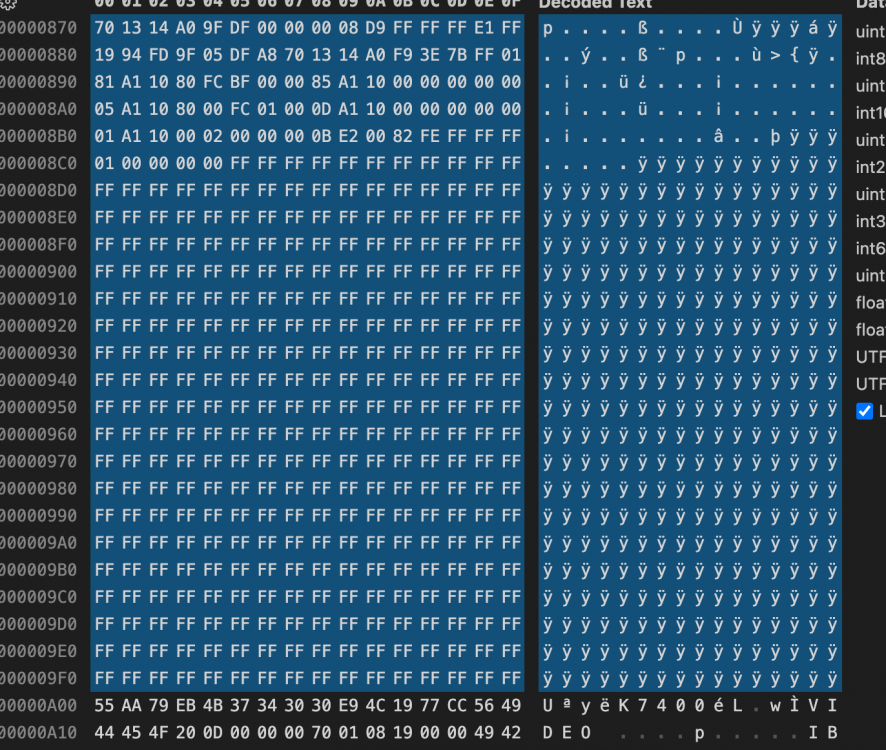

yeha I extracted with a windows (dual) boot and gpuz and removed all the lines before U�  until the start of the rom file the selected is removed in the fixed rom file.
I did extracted the rom yesterday.

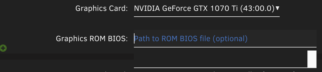

Edit: On addition, when selecting the bios from config gui there is a empty block so no access to the filesystem via gui i have to paste the path manually:

12 hours ago, AquaWolf said:
on 6.9.2 Unraid my both windows 10 VMs worked like they should both were working with GPU passthrough with a gtx 1070 ti
The edit to vbios seems correct, what was your setup when running 6.9.2?What did you change (for sure the rom?, grabbed yesterday)?
