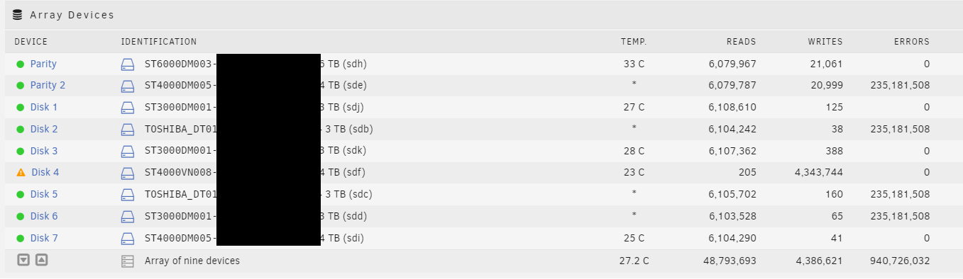

On my unraid server, I currently have 2 parity drive (6TB and 4TB) and 7 disk (3TB or 4TB).
yesterday I was getting SMART errors from a disk in my array.
So I ordered 2 new 4tb seagate Ironwolf drive.
I replaced the drive with the new ones.  Everything seems to work fine.  And then the parity / sync was halted and 2 other drives were getting some errors (1 parity and 1 another data drive).
The 2 drives with errors were disabled and the one I tried to replace was "Emulated".
My error, i think, was to unassign the "disabled drive" and start the array as now, I cannot start it again since it is missing 3 disk.

Not sure if everything will be ok after.  Parity Sync is at 67% but there are a lot of errors.
All those disk seems to be connected to the unboard sata.
I'll order another one to replace rapidly
It won't, would need to see the diags to confirm but like mentioned above it's most likely the same controller issue, it tends to be worst under load, like during a parity check or rebuild.
You can cancel the current rebuild and try again later, ideally without using the onboard controller.
