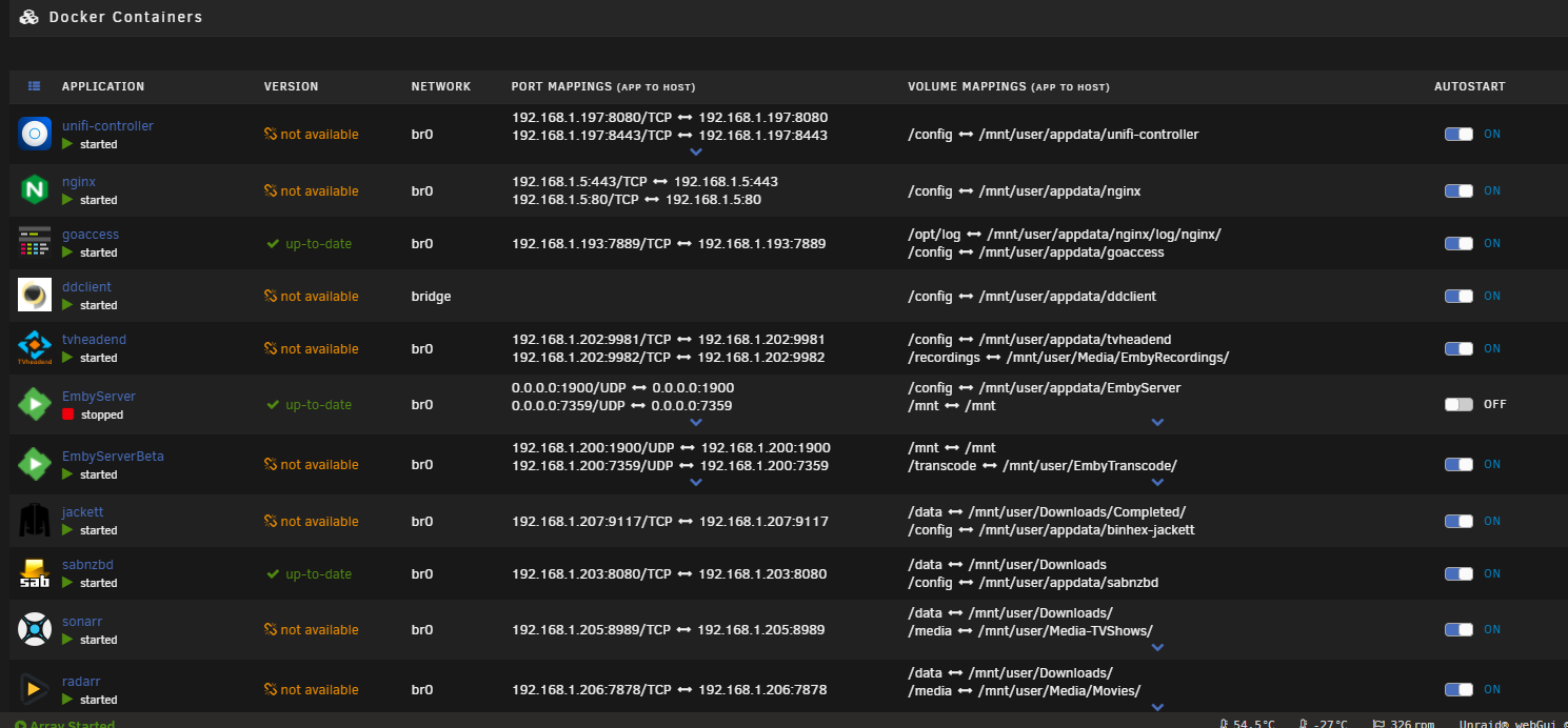

Random dockers showing version Not Available - cant update
This happened overnight.  I did have a pre clear runnning.....  Stopped that.

If I try to update any of these :

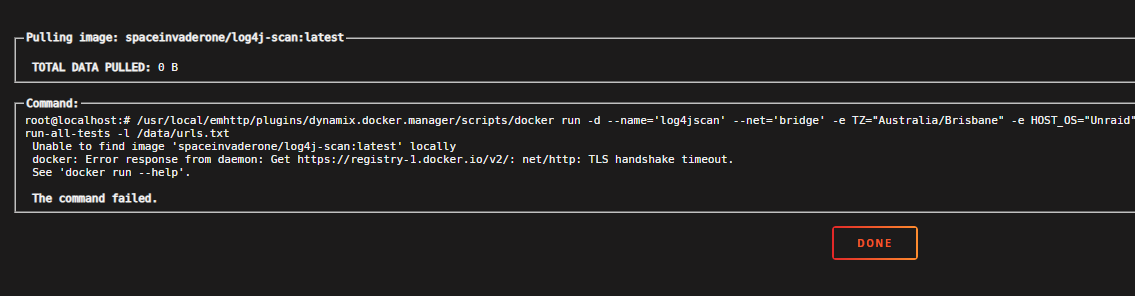

I just tried to install a new docker from the apps - and I got this - which may relate to the issue ?
Is there something wrong with registry-1.docker.io ?

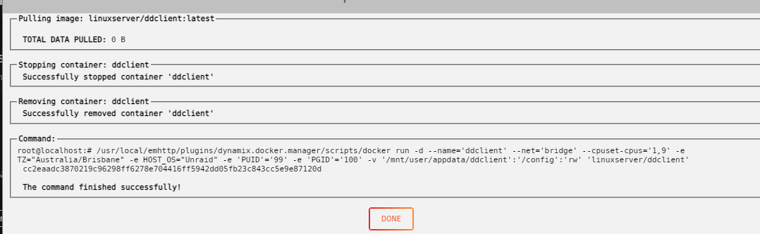

I again installed that test docker above and it then installed.
I did a docker check for updates and they all came back with their expected statuses.

Or was it as issue with this error and someone remotely fixed their problem - docker: Error response from daemon: Get https://registry-1.docker.io/v2/: net/http: TLS handshake timeout.
