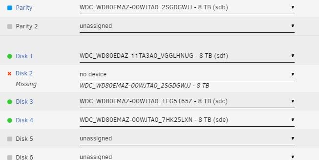

I recently had my usb drive die on me.  I replaced that.  Got it registered and now I'm trying to assign my drives.  I wasn't sure which was the parity drive so I mounted all the drives to see which one wouldn't mount and selected that as the parity drive.  Now I think it thinks that I'm supposed to have more drives than I do.  That I'm supposed to have 4 plus a parity drive not 3 plus a parity drive.   It says its an invalid configuration.

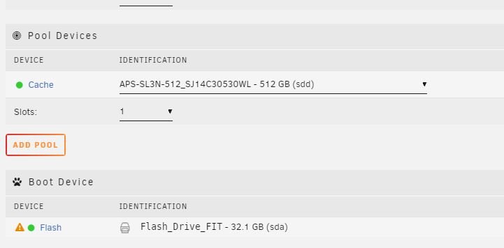

Also (I think I did this right) I added a pool and then selected my ssd drive as the cache device.
When I try to start the array it says 'Stopped. Invalid configuration.'
I'm not sure what to do at this point.  All the tutorials I find stop at how to replace the usb and don't go into re-selecting the drives.
Tools, new config. That will allow you to place the drives in any slots. BE ABSOLUTELY SURE you are not assigning a data drive to the parity slot. TRIPLE check.
Ahhh damnit.  I had tried that but I kept hitting done and not apply.  I'm an idiot.  Thank you.
