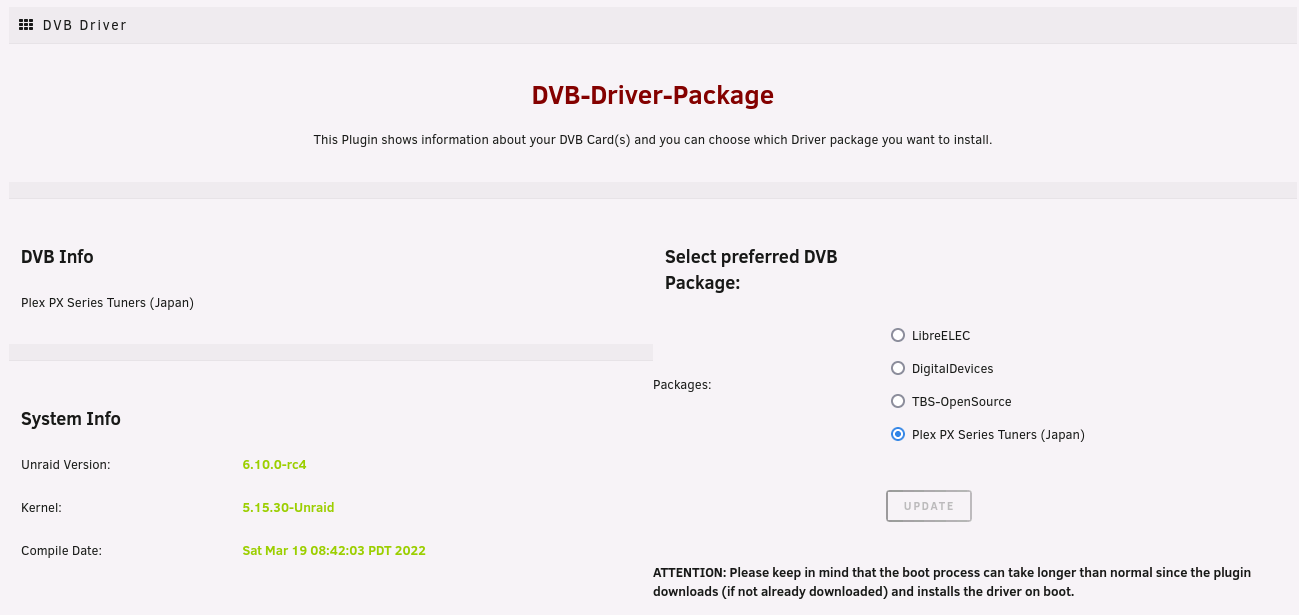

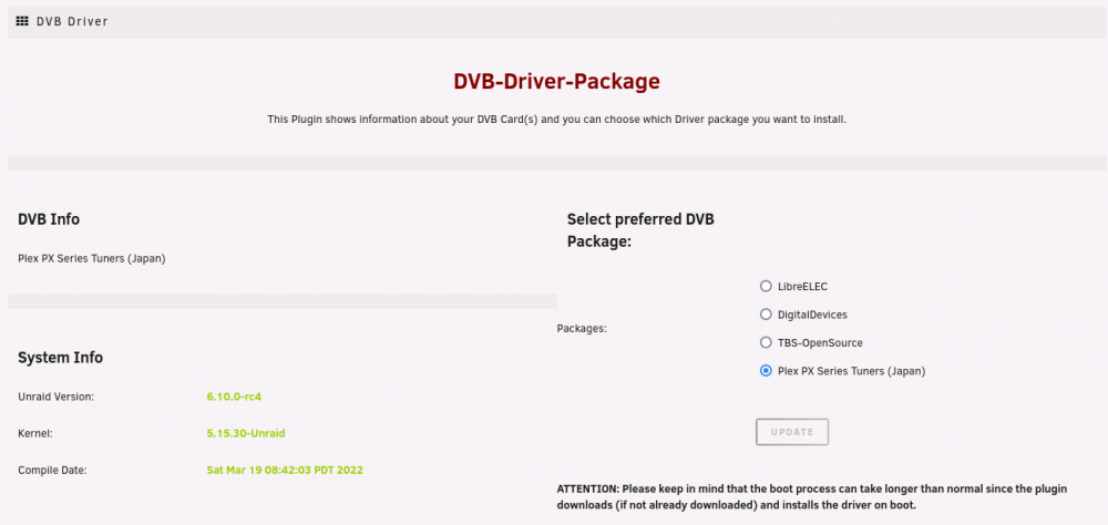

March 30, 20224 yr @untan Plex PX Series Tuners (Japan) are now available in the DVB Driver plugin (currently for Unraid 6.9.2 & 6.10.0-rc4 and will also be compiled for the coming Unraid versions): Please update or install the plugin and make sure that the plugin version is 2022.03.30, select the Plex PX Series Tuners (Japan), click Update and restart your server.
March 31, 20224 yr Author @ich777 The plugin is working fine with 6.10.0rc4. Thank you very much. Edited March 31, 20224 yr by untan
