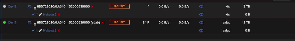

I have 7 Unassigned Drives connected via the HBA.  I had an 8th drive in a 4 bay USB 3.0 enclosure.  It was formatted and working fine.  I turned off the enclosure and added a 9th drive.  Now, both drives are listed as Dev 9 and the one that should be Dev 8 has no device label (should be sdaa) and both show the same mount point "tvshows2" which was the mount point for Dev 8 as the new Dev 9 is not formatted and has not been mounted.  This is the entries from the system log:

I removed Dev 9 until I can get an answer, getting this error for the original and unchanged Dev 8.  :(

Apr 18 19:28:36 Tower kernel: XFS (sdaa1): Filesystem has duplicate UUID 42df9b8c-66be-4d9a-986b-522f706f27ad - can't mount
Apr 18 19:28:36 Tower unassigned.devices: Mount of 'sdaa1' failed: 'mount: /mnt/disks/tvshows2: wrong fs type, bad option, bad superblock on /dev/sdaa1, missing codepage or helper program, or other error. '
Apr 18 19:28:36 Tower unassigned.devices: Partition 'tvshows2' cannot be mounted.
Also get this when trying to change the UUID.
Apr 19 09:51:18 Tower ool www[13312]: /usr/local/emhttp/plugins/unassigned.devices/scripts/rc.settings 'uuid_change'
Apr 19 09:51:18 Tower unassigned.devices: Changed partition UUID on '/dev/sdaa1' with result: ERROR: The filesystem has valuable metadata changes in a log which needs to be replayed. Mount the filesystem to replay the log, and unmount it before re-running xfs_admin. If you are unable to mount the filesystem, then use the xfs_repair -L option to destroy the log and attempt a repair. Note that destroying the log may cause corruption -- please attempt a mount of the filesystem before doing this.
