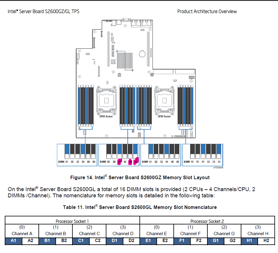

Fix Common Problems identified that I have an MCE error.  I took a look at my logs and found this:
1 CE memory scrubbing error on CPU_SrcID#1_Ha#0_Chan#1_DIMM#0 or CPU_SrcID#1_Ha#0_Chan#1_DIMM#1 or CPU_SrcID#1_Ha#0_Chan#1_DIMM#2 (channel:1 page:0xd7237f offset:0x0 grain:32 syndrome:0x0 -  area:DRAM err_code:0008:00c1 socket:1 ha:0 channel_mask:2 rank:255)
First - is that going to be the source of the error? I didn't have the MCE log installed in NerdPack so I'm not sure how to check that.
Second - assuming that would be the source of the error - would the highlighted slots be what I'm looking to pull in order to find the culprit?
Check the board's system even log in the BIOS, there should be more info there.
