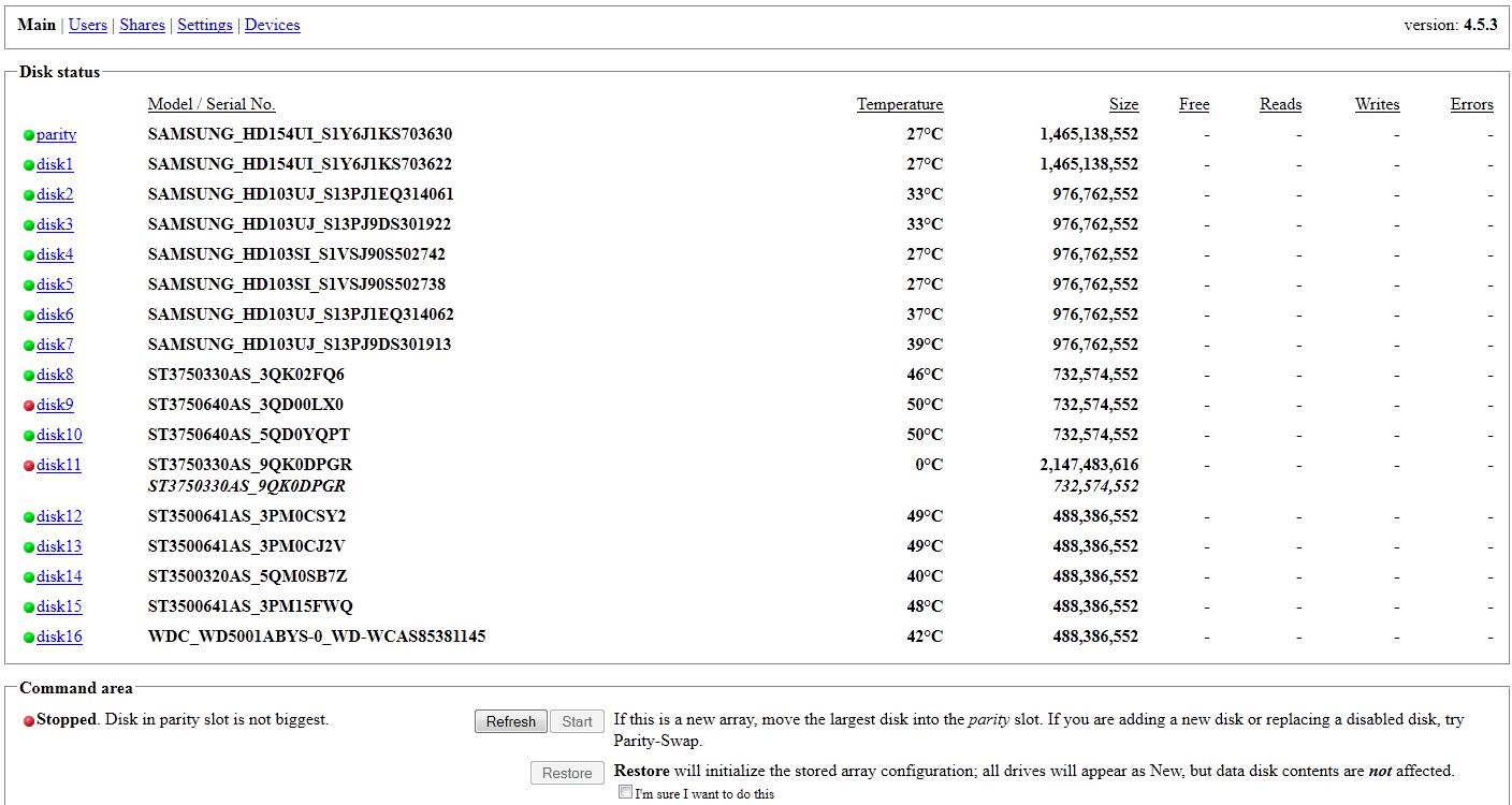

Been running UNRAID 4.5.3 for a while now with no issues.  Tonight I couldn't get a movie to play from my UNRAID server so I logged in and noticed disk 9 is having a problem.  I pulled the drive and dropped it into my external hard drive dock and it came up as a healthy drive.  I put it back in the UNRAID server and changed the SATA cable.  Still no luck but now my disk 11 is showing as too big and the system says "disk in parity slot is not biggest".  Disk 11 now also has a red dot and shows as being 2.1TB when it's a 750GB drive.  A screenshot of my status page is attached.  Hoping someone can help figure this out.  I'm hoping I haven't lost my data but it's really nothing that can't be replaced.  I'm shutting it down until I have something I can try to fix it.  It's been rock solid for quite some time.  I was hoping to reduce my drive count in the near future by upgrading the drives to larger 2TB drives.  Cutting the heat and noise in the server.
The only thing I can think of to try and at least fix the parity drive issue is to run some error correction on my disk 11.  Hopefully someone here might know what to do in this case.  I'm about to lose 500 plus movie rips.

The drive 11 issue is really odd. The syslog or the info from Joe's commands might help figure out what is wrong with it.

Thanks for the responses.  I can't boot the server now.  My Supermicro board just beeps long continuous beeps over and over.  I swapped the RAM around and it beeps 4 times then looks like it's running but nothing comes up on the screen.  The board has been doing this for a little while on and off.  I had been able to boot it several times recently but tonight when I went to get the syslog and run the smart report it would not boot.  I'm going to swap out the board with the same model and see if I can bring the system back up.  Maybe that will fix the problem or at least get me to the point I can generate a syslog and run the smart report.  I'll check back in a few days once I have the board and can swap it out.
Is it a bad idea once I swap out my motherboard to update my UNRAID version to 4.7?  I would backup my current UNRAID flash drive before doing so.
Swapped the motherboard and then figured out it was the RAM.  Got the server booted fine but I still have the same situation as in the first post's screen shot.  So I'm stuck basically.  Disk11 shows as being 2TB while it's only really 750GB.  Refresh does nothing, I could try Restore but I'm not sure what that will do to my data.  I may try to swap the cable on Disk11 and see if that changes anything.  Also thinking of trying an upgrade to 4.7 to see if that does anything.  Any suggestions would be appreciated.

Let's say I were to replace these two drives with other drives I have laying around.  Would I only lose the data from these 2 drives or do I lose everything?
Also swapping the cable and upgrading to 4.7 didn't help at all.
Both of the drives having issues are 750GB seagates.  I may try to flash the firmware with the seagate tool to see if that fixes the issues.

Somehow, your disk11 got messed internally. Updating the firmware might fix it. Otherwise, there might be some command that could get it to go back to the right size. We might know what it's problem is when we see the output of those commands.
Also, is disk9 dead or not?

Going to flash the firmware this morning.  It was midnight when I got to that point last night and I was just beat.  Disk9 shows up in YAReG and I am able to copy off files, Windows says it's a healthy partition.  During the boot process the controller card in the UNRAID server shows Disk9 as 0GB.  Hopefully this and the Disk11 problem are related to firmware.  If this works I'll run the other Seagate drives through the firmware tool as well.  I'll post again once I do the firmware updates and if that doesn't work I'll run the commands and post the output here.
Disk11 hdparm
root@UNRAID:~# hdparm -I /dev/sdj

DISK11 smartctl

==> WARNING: There are known problems with these drives,
AND THIS FIRMWARE VERSION IS AFFECTED,
see the following Seagate web pages:
http://seagate.custkb.com/seagate/crm/selfservice/search.jsp?DocId=207931
http://seagate.custkb.com/seagate/crm/selfservice/search.jsp?DocId=207951

DISK9 hdparm

The seagate tool would not flash firmware to either drive.  I then tried seatools and disk9 passed the short test while disk11 failed.  Using YAReG I can see the data on disk9 but not on disk11.  Then again I'm not real sure disk11 had any data on it.
Here's what I get when I click on disk settings for 8 (healthy disk) then 9 and 11.
disk8 settings
Partition format: MBR: unaligned
File sytem type: reiserfs
disk9 settings
Partition format: unknown
disk11 settings
Partition format: error
File sytem type: (partition 1 does not exist)
If I'm willing to lose the data on both drives couldn't I just replace the drives and start the array back up.  For Disk9 I can copy the data off using YAReG and my Windows PC.  Disk11 I'll have to figure out what I'm missing if anything.  Would replacing the 2 bad 750GB drives with 2x 500GB drives be a bad thing.  It's all I have on hand.  I'm probably going to get some 2TB drives soon but the largest drive in my UNRAID server is 1.5TB so one of the new 2TB drives would need to be the parity drive.  With the 2 dead drives I'm pretty much stuck in limbo right now.
hdparm and smartctl info on page 1 of the thread.
Disk9 looks ok except it was cooked in the past. That disk and probably your system is running too hot. Are your fans working?
SMART need to be enabled on DISK11. Enter:
smartctl  -s on -a  -d  ata  /dev/sdj
smartctl  -a  -d  ata  /dev/sdj
I'm not sure if the second line is needed but it won't hurt.
Disk9 is very hot to the touch.  The fans are working but this drive sits behind a row of 6 drives in the case so the air flow to it is blocked a bit.  I'll probably be replacing the 7200rpm Seagates with Samsung green drives.  That should cut the temps.
I'm replacing Disk11 first to see if I can get the array back up and running, then I will look to replace Disk9.  Worst case, I'll replace both drives and copy off Disk9 data from my Windows PC since it's readable with YAReG.  Disk11 is not readable so I'll lose that data.  I'm not sure there is much on Disk11 anyway.  I'll find out soon enough.
Update - Replaced Disk11 and fired the array back up.  All is good now.  Disk9 is back online and the Parity check completed with no errors.  I did lose my data from Disk11 but I should be able to put it back rather quickly.  Disk11 is dead.
