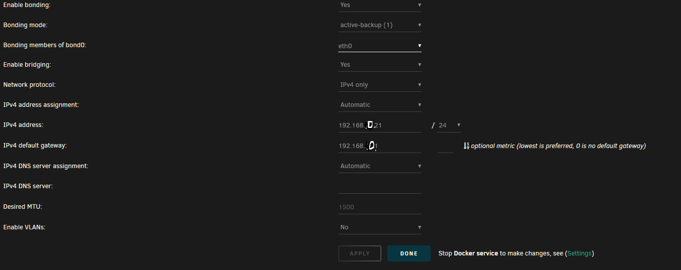

I have 2 servers running unraid that have 2x1GB and 2xSFP+ 10GB network connections.  I do not have a 10GB switch, so am trying to have 1GB connection to my switch for internet and general network connectivity.  Separately I am trying to setup direct connect on SFP+ between the 2 servers, on a separate IP, not part of the bond.  Once setup, I can ping between the servers, can ping to my main netowrk, and can search community apps for plugins, but the additional docker hunb search doesnt work.  And if I try to install a plugin, the download fails.

You need to use different subnets, e.g. use 192.168.0.x for 1Gb and 10.10.10.x for 10Gb, also leave the gateway blank for the 10Gb.
ok, eth0 is my 1gb, eth2 is the fiber.
I have eth0 as dhcp, with router giving ip of 192.168.0.21, and gateway of 192.168.0.1
eth2 is static definition, 10.10.10.21, with no gateway.
rebooted for good measure.  Community apps fails to pull list at all.
I can still connected the web ui on 192.168.0.21.
Routing Table has
Protocol	Route		Gateway			Metric	Delete
IPv4		default		192.168.0.1 via br0	217
IPv4		10.10.10.0/24	eth2			1
IPv4		10.226.0.2	wg0			1
IPv4		10.226.0.3	wg0			1
IPv4		192.168.0.0/24	br0			217
wg0 is from my wireguard setup
Edited by Vilhjalmr
Does the brigde only have eth0?
yes
