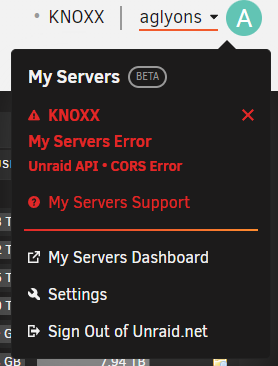

May 19, 20224 yr Came across this recently and it won't go away. I searched around the forum and found nothing. knoxx-diagnostics-20220519-1233.zip Edited May 19, 20224 yr by aglyons Diagnostics

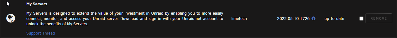

May 19, 20224 yr I'm guessing you're running a reverse proxy? That isn't currently supported but is coming. First, go to the plugins tab and make sure the My Servers plugin is up to date. Then open a web terminal and run: unraid-api report -vv If you look in the ALLOWED_ORIGINS area it will tell you which urls are supported. If the url you are using is not in that list then you will get the CORS error. Note that the command above has -vv, which is non-anonymized data that you probably don't want to post. If you have questions, you can post anonymized data from: unraid-api report -v
May 19, 20224 yr Author Nope, no RP -yet that is. I do plan on going there once I get the hang of it. Plugin is up to date report contents looked ok to me too <-----UNRAID-API-REPORT-----> SERVER_NAME: KNOXX ENVIRONMENT: production UNRAID_VERSION: 6.9.2 UNRAID_API_VERSION: 2.46.3 (running) NODE_VERSION: v14.15.3 API_KEY: valid MY_SERVERS: authenticated MY_SERVERS_USERNAME: aglyons RELAY: connected MOTHERSHIP: ok ONLINE_SERVERS: KNOXX[owner="aglyons"] OFFLINE_SERVERS: ALLOWED_ORIGINS: http://localhost, http://192.168.XXX.XXX, https://192.168.XXX.XXX, http://knoxx, https://knoxx, http://knoxx.local, https://knoxx.local HAS_CRASH_LOGS: no </----UNRAID-API-REPORT----->
