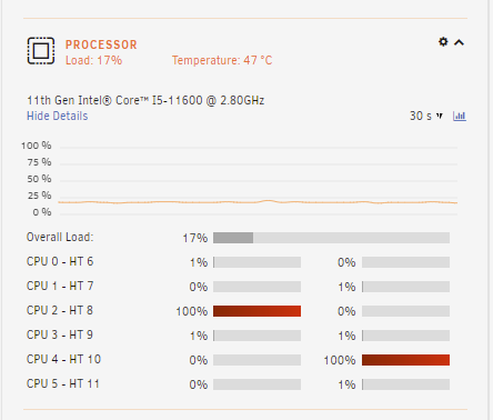

Processor usage is higher than 6.10-rc2. There I had under 10%.
Now 2 cores are continuesly at 100%:
Edited by D.Romeleitis

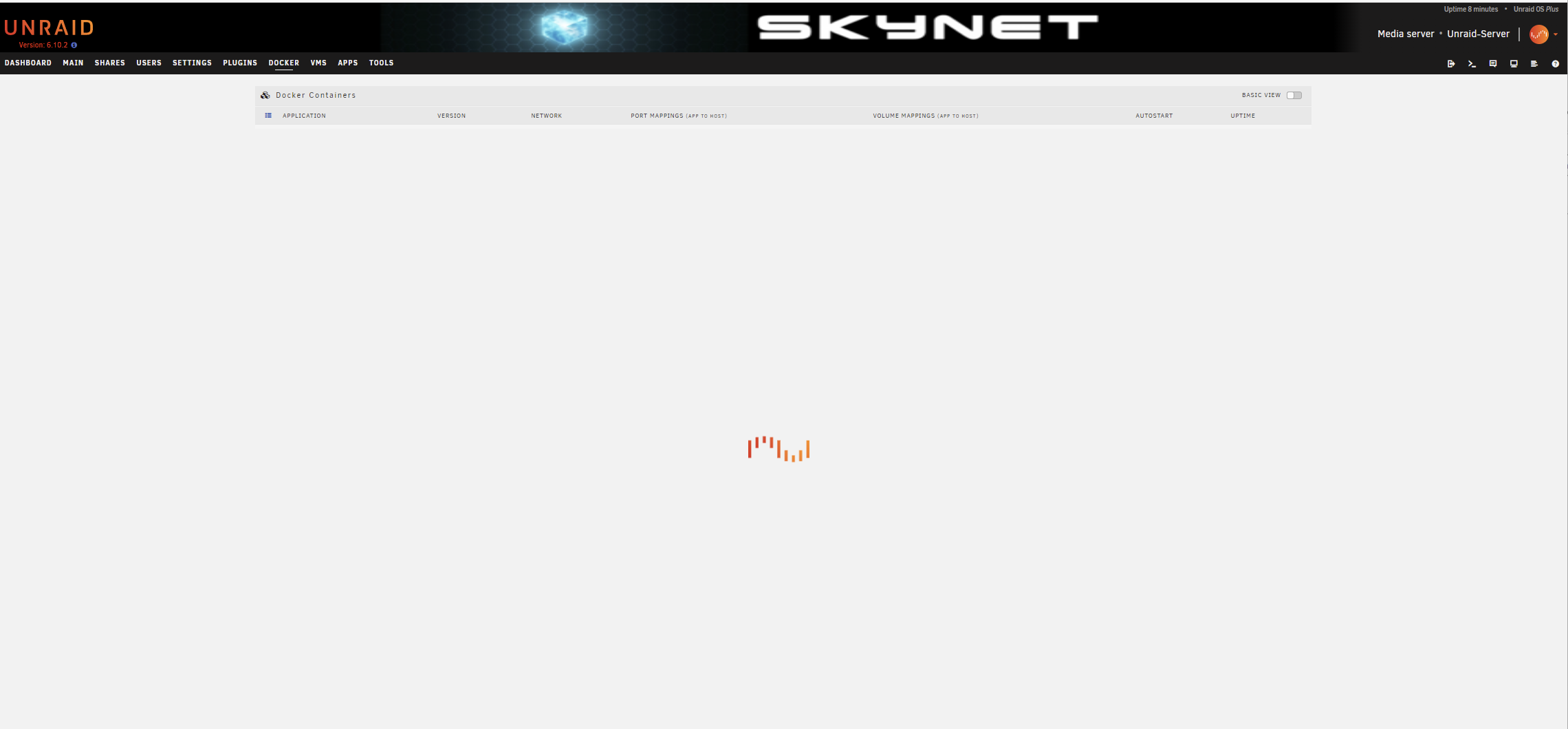

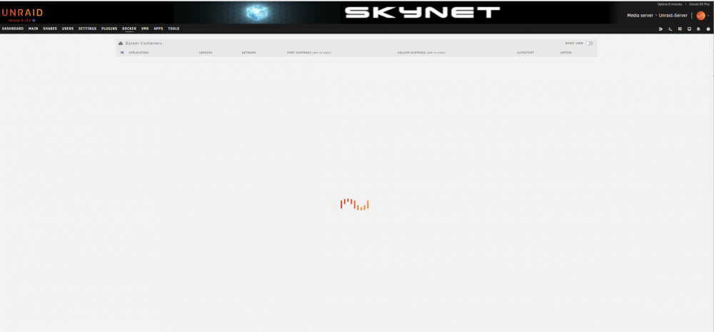

I started the array. GUI is more performant than before. The docker tab is still very slow showing the containers...
I have this window since minutes :
syslog.txt
I tried to get the diagnostic information, but still the same window like before...

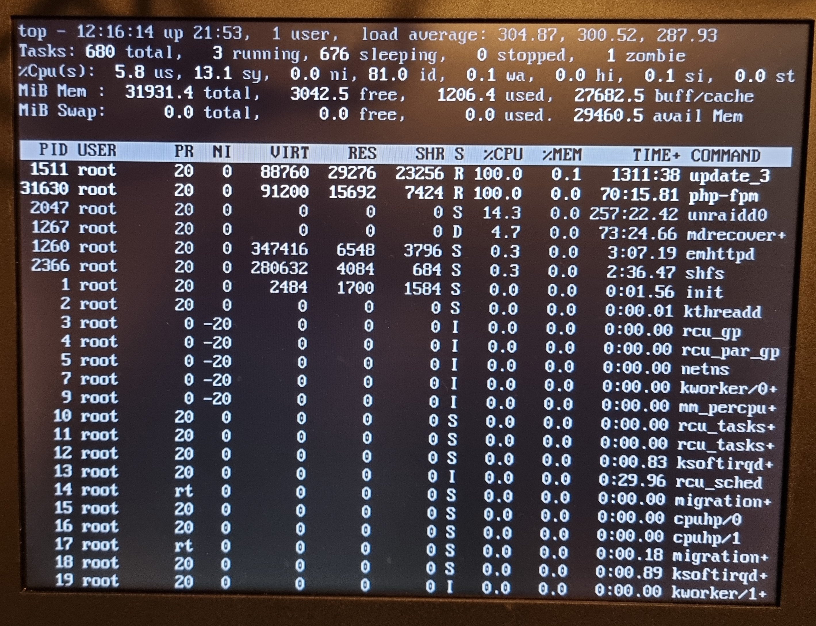

Result of top command...20220529_121616.thumb.jpg.52b3e45ea451792e25bbab667afcb78f.jpg
