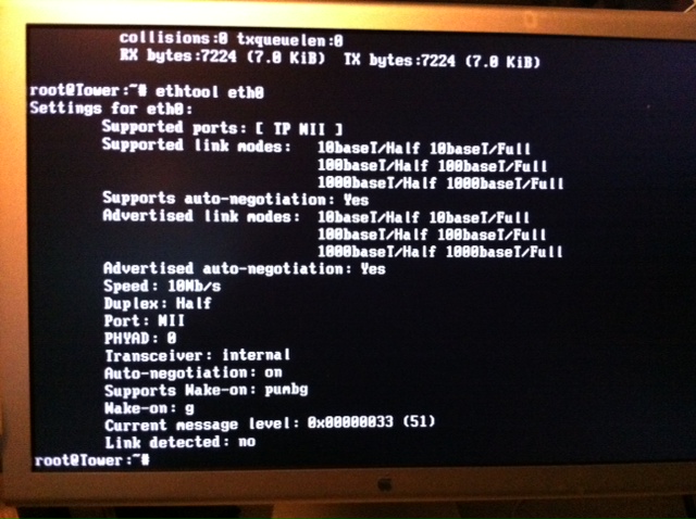

I'm so close to getting my Unraid to work perfectly. The only problem I seem to be having now is random disconnects when moving large files. With the help of others on the board I found that my realtec NIC could be the problem. I'm trying to install a new Intel-based card that came today but I have no clue about how to turn it on and get to talk to my system. So close and yet so far away. Could someone please take a look at the JPEG I have included using the line command: ethtool eth0 ?

Did you plug the LAN cable into it?  (it appears no link is being detected)
Yes I did. Same one as used in my onboard card. ( which linked fine.)
You don't have MAC address filtering on your network, do you? New card, new MAC address.  Just trying to think out loud.
And the other end of cable is still plugged into your router?

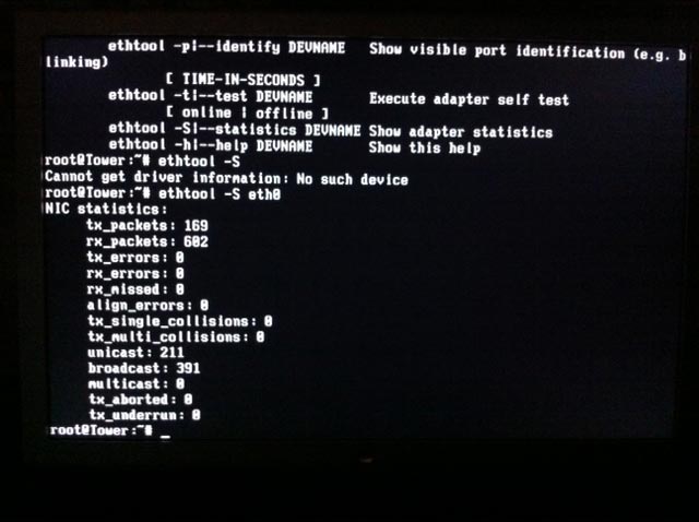

Give us an ethtool -S eth0

ethtool -S eth0 Is attached as a JPEG. One thing I am noticing is that the onboard LAN is not disabled even though I've carefully selected that option when setting the the BIOS.  it continues to function even though the new NIC card does not. Hope I'm giving you the right information here. I am definitely not experienced with Linux stuff!

Your syslog says eth0 is the built-in Realtek, which would explain no link on the Intel. The Intel shows as eth1. What I've read here so far says eth1 use isn't obvious to configure or we could just go that direction. Might be better to work harder at disabling the Realtek.
When you disable the Realtek, does it re-enable itself or just not pay attention to the setting? What board is this? Which BIOS screens have you used to disable the nic?
