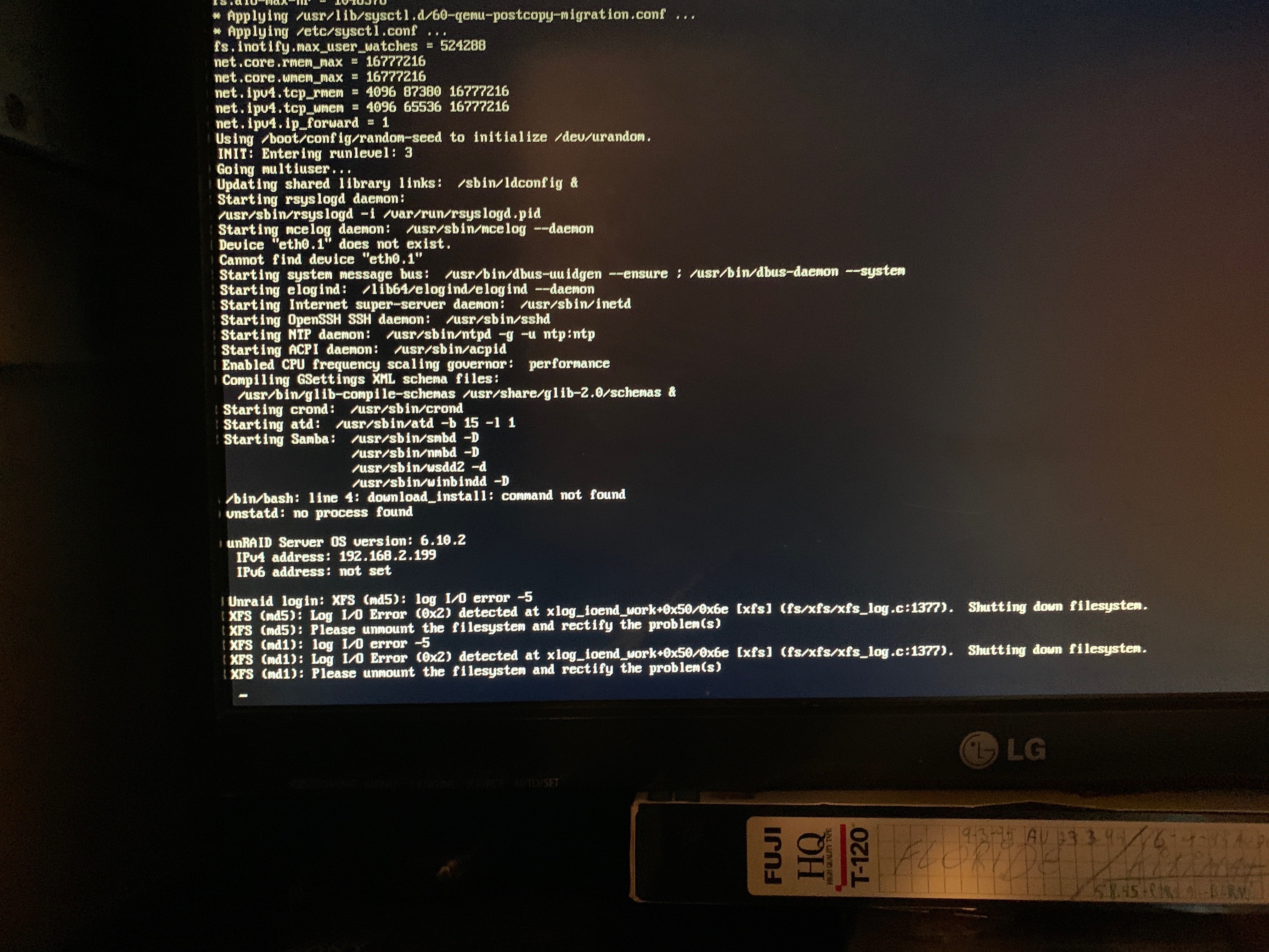

Started a VM and disk 5 went into error, followed by tons of IO errors on parity!
Earlier today I went to start a VM on my server and a disk (Disk 5) immediately went into error. I stopped the array, de-assigned the disk, started the array again, stoped it and re-assigned the disk. After the data rebuild on that disk I tried again to start the VM and the same thing happened.
Except this time my SMB shares wouldn't work, I had 7M + errors on my parity drive (Disk 0) and the log immediately filled to 100%.
I managed to grab a log before shutting everything down. First of all I'd like to make sure I didn't lose data and second of all I'd like to know what caused this issue and is it safe to reboot and bring the system back online.

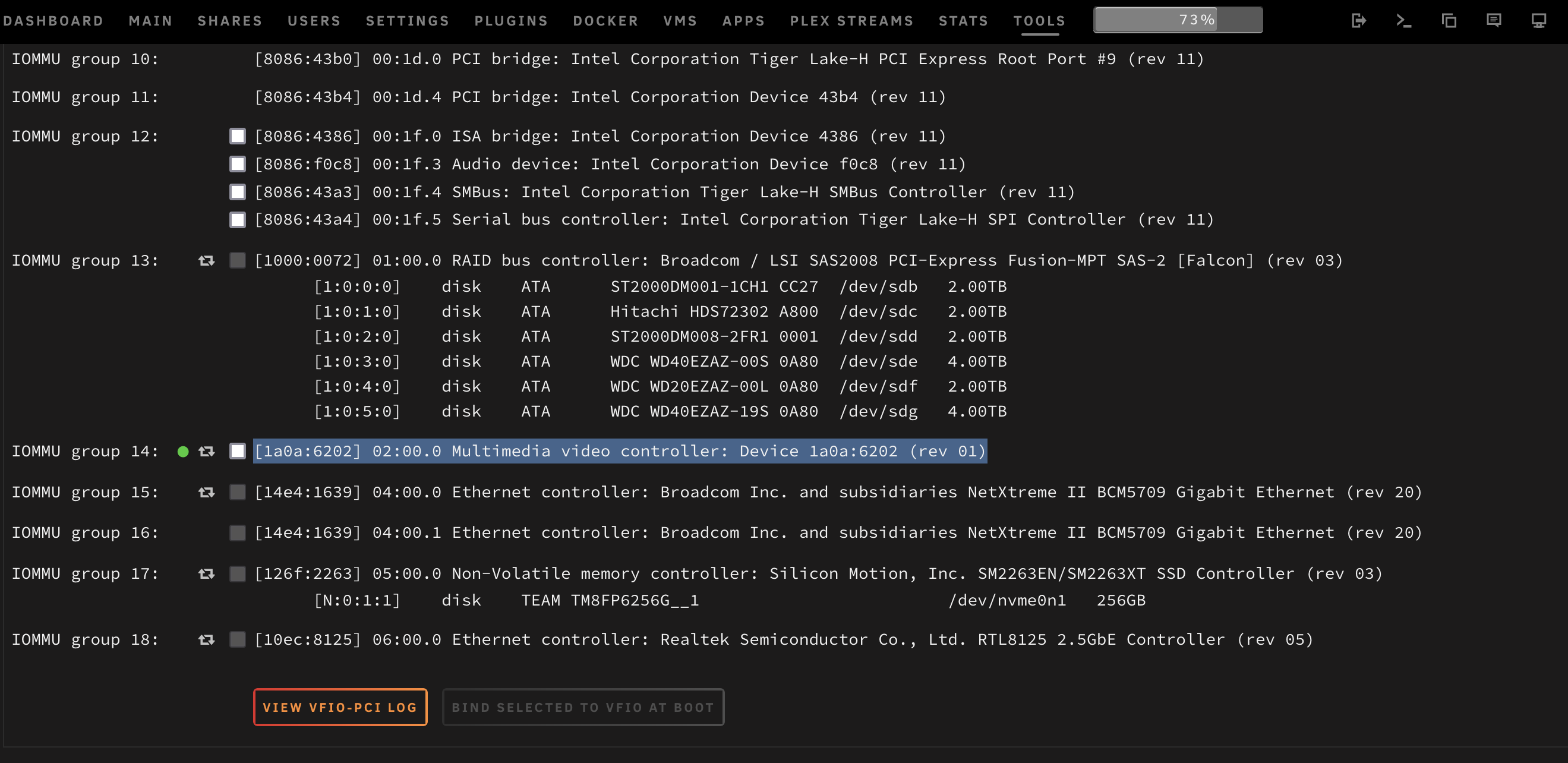

Sorry to revive such an old thread, but I was never able to start the VM back up. Even if I uncheck every devices on the "edit" screen for that VM, it crashes my whole server every time. Is there any other way to force remove the controller from the VM while still passing my capture card? Ideally without deleting and re-installing the VM? Here is the XML for that VM

And here is the device I'm trying to parse (See attachment)
Thanks
