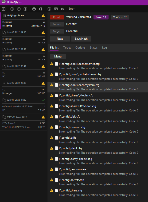

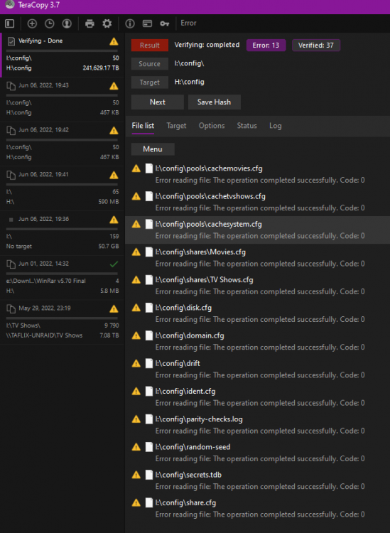

The contents of the original Samsung USB flash drive is readable.

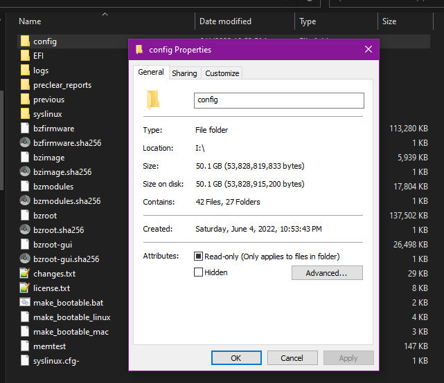

However, I cannot copy it onto a new USB flash drive because the config folder is 50.1 GB and the new drive is only 8GB:

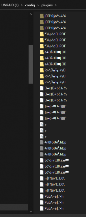

The original Samsung USB flash drive is only 32 GB.  It looks like the PLUGINS folder was corrupted?
I tried copying everything except for the PLUGINS folder, but got read errors on these 13 files:
Edited by HDT
Definitely sounds like major problems on the flash drive.   I suspect it Is failing but the only way to be sure will be to try rewriting it.   The config folder should only be a few hundred Mb so there is definitely something seriously wrong.
Your disk configuration is in the config/super.dat file so it looks like you may have managed to copy that OK.  Hard to be certain as it is not human readable.   You also seem to have copied the .key licence file OK?   Looks like most of the other default configuration files are gone.
Sounds like you have little choice except to try creating a new flash drive and reconfiguring your Unraid server.   Copying across the super.dat file (if it is not corrupt) and the licence .key file will hopefully slightly reduce the amount of re-configuration needed.
