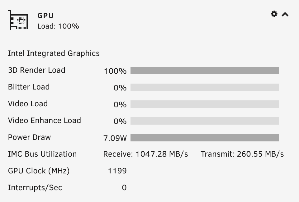

June 5, 20224 yr Unraid Version: 6.10.2 (same issue with 6.9.x) CPU: Intel Xeon e2278G Motherboard: Gigabyte C246-WU4 Dockers Using QuickSync: plexinc/pms-docker, blakeblackshear/frigate:stable-amd64 I have run Plex in a docker with hardware transcoding via Intel QuickSync for years without issue. For the past several months I have the following issue: Plex works fine for several days, hardware transcoding works as expected. Plex fails to play any video file that requires transcoding (direct play continues to work fine) GPU Load is listed at 100% (see below, screenshot taken while frigate and plex docker stopped) Only way I can get it to work again is rebooting server. Any suggestions on how to troubleshoot or recover or fix it? Thanks! Edited June 6, 20224 yr by daves

June 6, 20224 yr Author Hmmmm, this doesn't feel like an issue with Plex. Transcoding works...until it stops working and a reboot is required. I suspect that it's an issue with the i915 driver. Edited June 6, 20224 yr by daves
