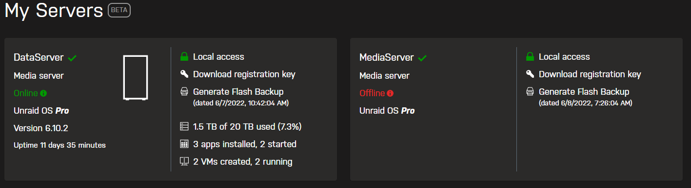

One of two servers always shows offline
I have two servers.  One of these always shows offline in  My Serversbut it looks connected?  Have tried a few things but this does not ever seem to correct.  Was this way in 6.9.2 and is still this way in 6.10.2.  Has the latest My Servers Plugin installed.  Any suggestions?

Did some more digging based on the results from the command you suggested.  Found a similar post so I deleted the My Servers plugin and reinstalled it and all appears to be working now.....
