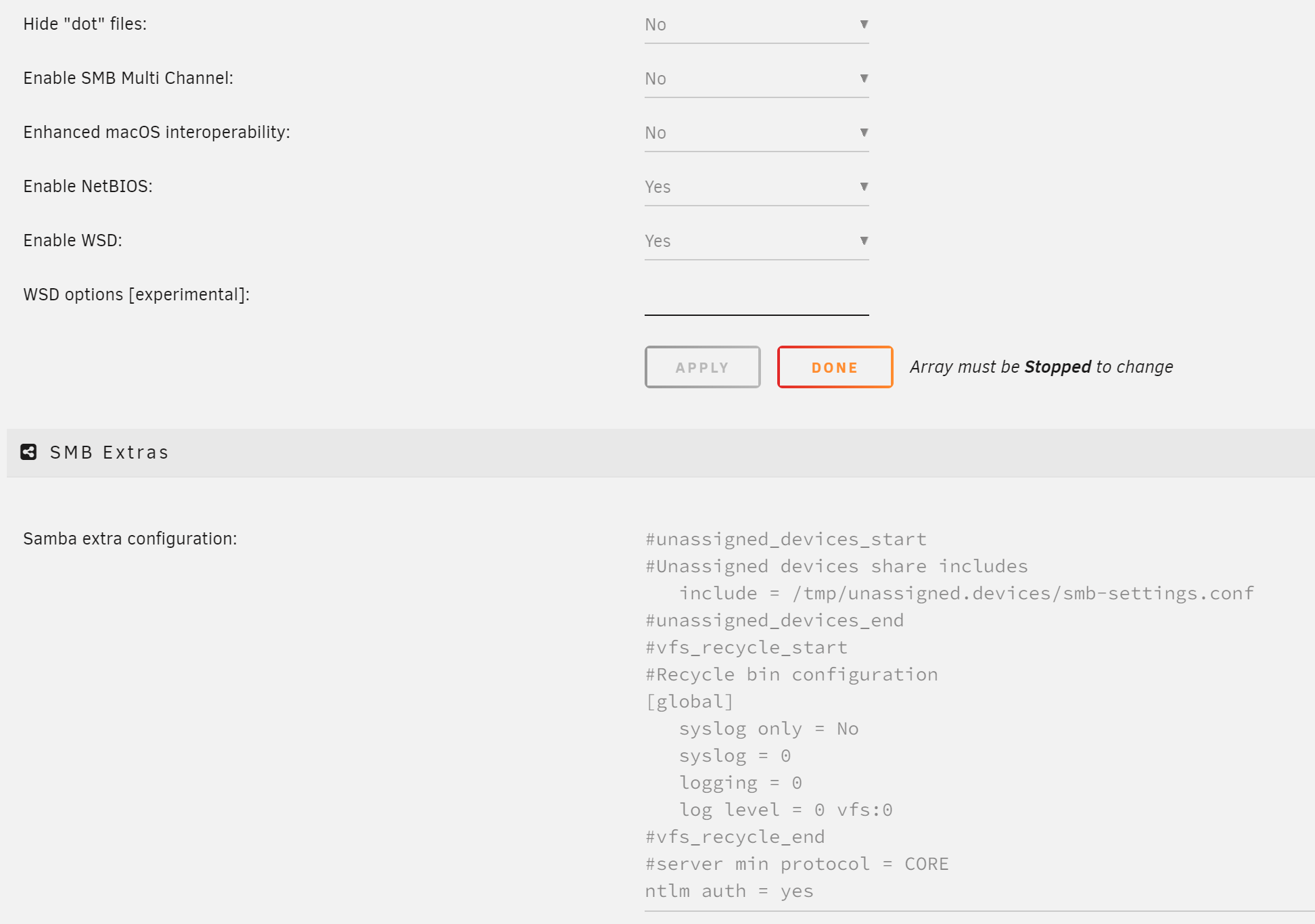

What i have done without success:
-adding "ntlm auth = yes" to SMB extras
-adding "server min protocol = CORE" to SMB extras, but "removed" it with an # right now
-enabling NetBios (SMB v1?!)
SMB is working fine all my other devices..

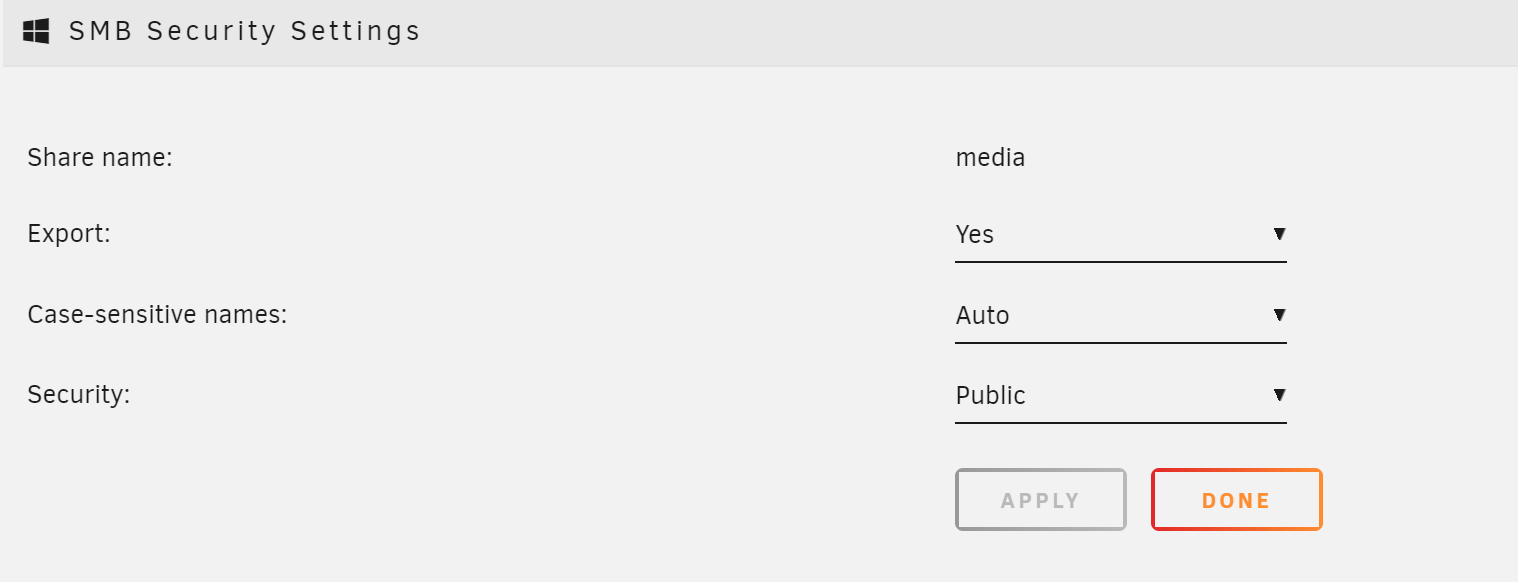

i tried all 3 settings, but right now it is on Public.
yes, i can see the share and after entering my Password it tells me, it is wrong.
no, i have a 4 digits password, only numbers. Also tried a test Account Name "a" and password "a", no luck here, always wrong password..
i found a lot that had to activate smb v1, but it didnt helped for me.
also found some with Linux Server and they had to to add "ntlm auth = yes" to smb.conf (which is smb extras here as far as i know)
what someone with debian Server needed, was that in smb.conf:
server min protocol = NT1
ntlm auth = ntlmv1-permitted
but i dont know how to write it right in unraid

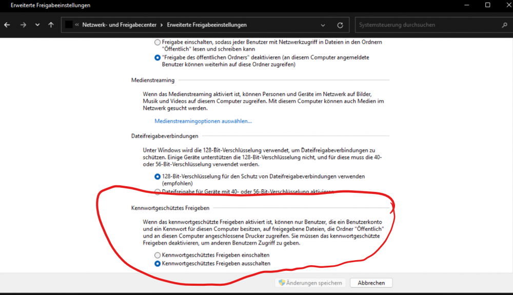

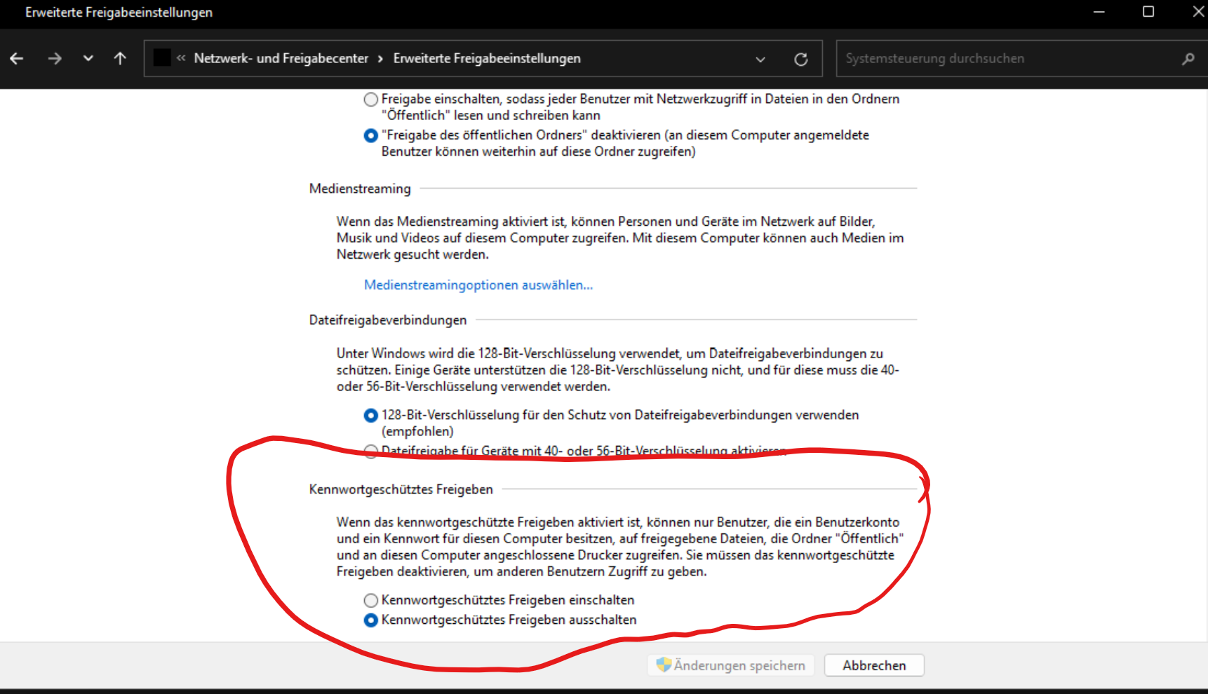

My tests with a Windows Share wasnt working until i deactivated Password Protected Sharing in Windows Sharing Konfigurations.
Before that, i had the same issues on Windows with the wrong Account Password.
Now i have to find out, how to get that working on unraid. (again it is already on "public")
