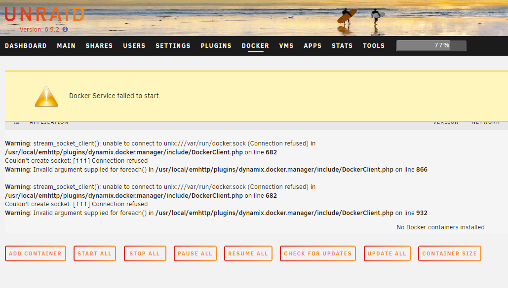

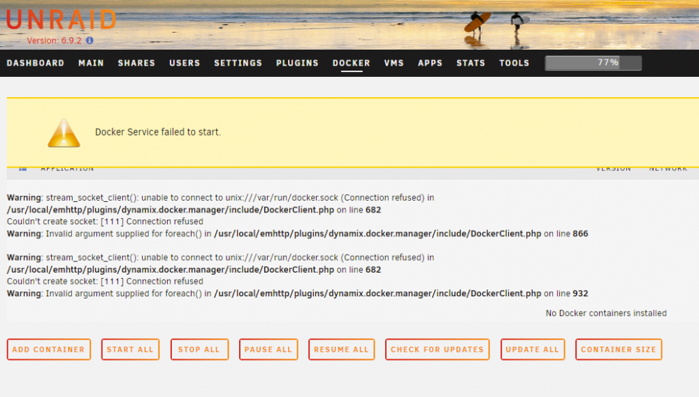

Docker Service Failed to Start.
My Cache drive had filled up so I manually invoked the Mover from the main page.  Sometime during the move the dockers became unavailable and even now that the move is complete, the docker service is showing errors and can not start.
I have tried stopping and starting the docker service from the settings page but I'm afraid to actually stop the server itself.
