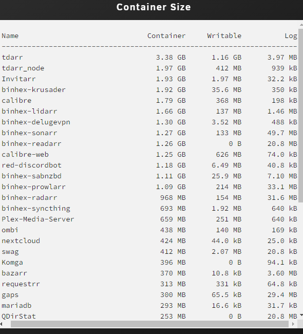

This was quite a while back so you'll have to forgive my memory on this but I do recall increasing the docker.img capacity at some point in response to adding more and more docker containers. Having a look at the container sizes themselves, with the exception of Tdarr which is using 3.38GB for its container (I'm looking into why that is), the rest are no no bigger than 2GB individually at the larger end.
I don't know what a typical docker image size should be or if those are all way too big and should be smaller? I've attached an image of the sizes that they are for the largest ones.
