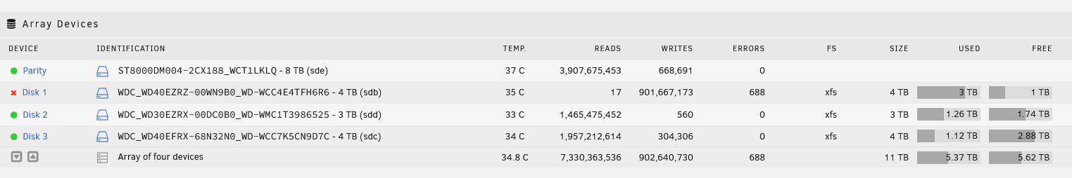

I've tried to rebuild on top but there are a lot of error and i can't use the disk. maybe there is some real issue with the disk?
Yes, SMART looks real bad, before it wasn't visible since the disk dropped but I should have asked for a SMART report after rebooting, in any case you need to replace that disk.
