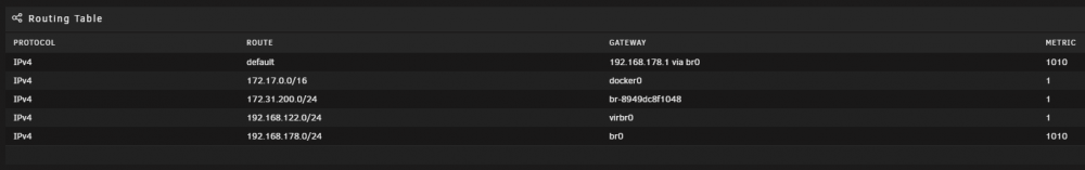

Hi, I 've a strange issue since two weeks. There are some trouble in my network routing involving the unRaid NAS.
From the NAS I can't ping some IPs e from that IPs the ping of NAS it does't work. The message in both direction is always "Destination Host Unreachable". The strange thing is that there is a small amount of IPs that can't ping the NAS and vice versa all others IPs works corerctly.
The only thing I made was to try WireGuard... (now disabled). I don't know if this has changed something in the routing table of the NAS.
Someone can help me to understand what's going on? or how to investigate the issue?

Uhmmmm there is only one cable from my unRaid box.... but take a look at this screenshot:
