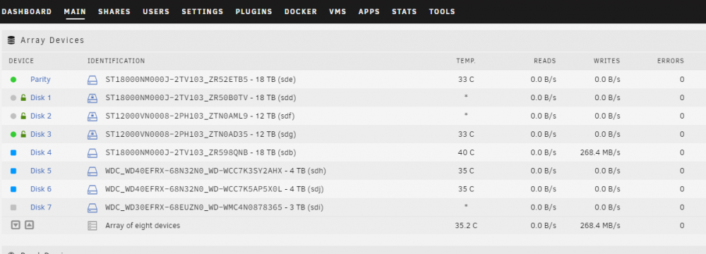

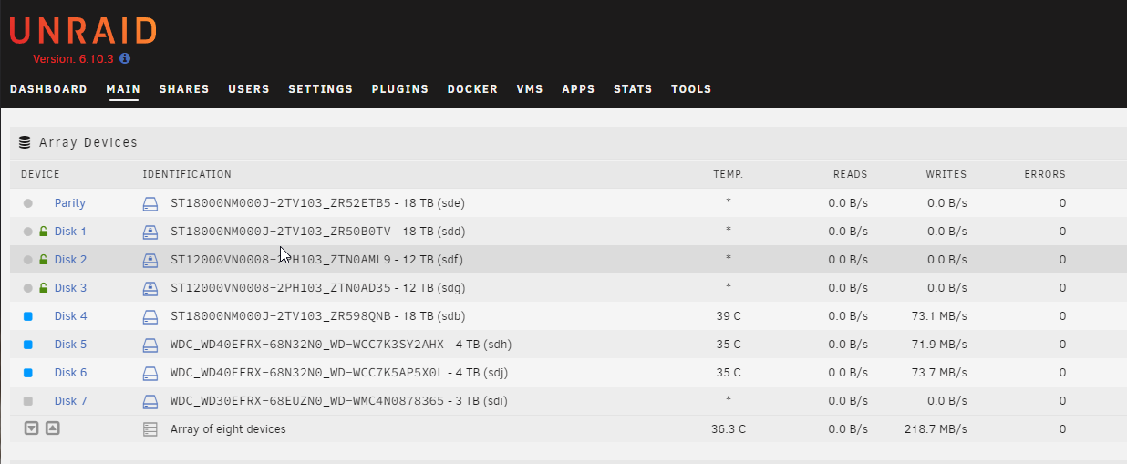

I just recently bought a new 18 TB HDD to be added to my Unraid setup. As I had some older 4TB HDD laying around I added them as well.
All new disks are connected using a PCI-E Sata card (BEYIMEI PCI-E X1 SATA - ASM1166+JMicron JMB5xx-Chip).
During the pre-clearing of all drives in parallel Unraid reached roughly 70MB/s per drive. After the smaller drives have been pre-cleared the 18TB peaked at 270MB/s. I am now wondering where this difference of speed originates. Is this due to the age of the harddrives, the PCI-E controller, or is this just "normal"?
If the PCI-E controller is a bottleneck, it would be easy to replace. If the harddrives itself are the bottleneck - well so be it. Can someone help me understand the differences in speed?

1315618532_2022-06-2911_13_31-Tower_Main.thumb.png.aa430040adefe31470fba5bdcf9605d1.png340756693_2022-06-2912_56_38-Tower_Main.thumb.png.e33fc65775fe60de6924a0f01875f091.png

This suggests the controller uses one or more port multipliers, if yes bandwidth of any SATA port connected to one will be divide by all 5 ports, diags would confirm.
Thank you Jorge. I just realisied that the 18TB is not connected via the card, but directly to the MB. So it seems that the card itself is a bottleneck, although it should have enough wiggly room with 6GBs to easily max out all of the harddrives currently attached to it. As the 4TB and 3TB HDD are only spinning at5400 RPM, I think it might be a combination of not so young HDD´s and the need to move data across the bus from the motherboard to the card.

Yes, also note that the clear thread runs for all the disks at the same position, i.e., speed will be limited by the slowest disk at that point, screenshot appears to show the end sectors of the 4TB disks, since the 3TB dis already done, so 70/80MB/s at the inner sectors for those disks is normal, probably not the controller being the bottleneck in this case, still controllers with port multipliers are not recommended for performance and stability reasons.
