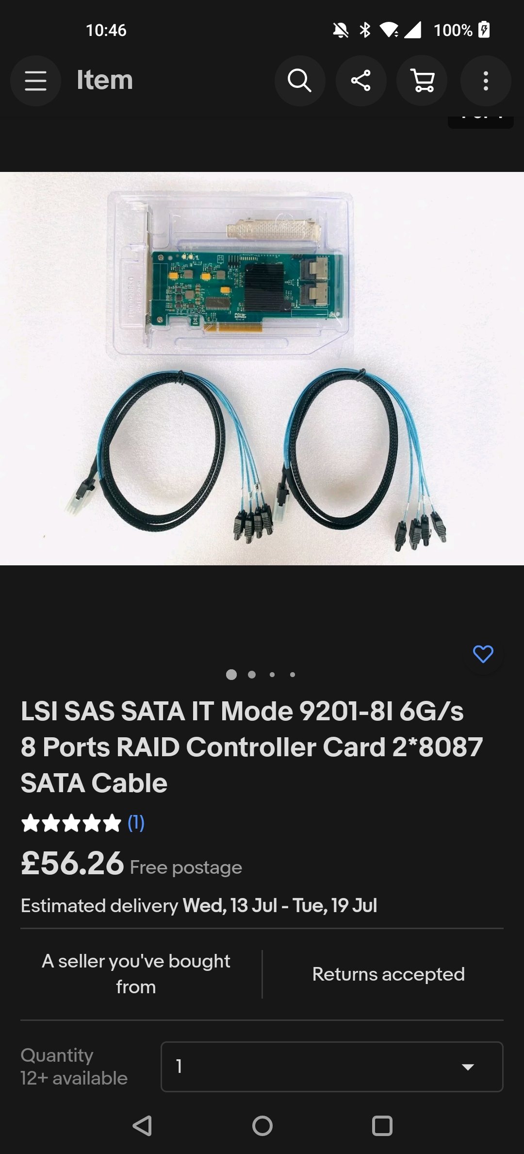

Hmm I bought the LSI as it was supposed to be in IT mode
If it's in raid mode how do I show it is so I can try get a refund from eBay?
I can't afford to keep buying disks so if I can get it back working with a firmware flash on the LSI card to put it in it mode then that would be preferable

Jun 30 01:55:04 Tower kernel: mpt2sas_cm0: LSISAS2008: FWVersion(20.00.06.00), ChipRevision(0x03), BiosVersion(07.39.02.00)
Jun 30 01:55:04 Tower kernel: mpt2sas_cm0: Protocol=(Initiator), Capabilities=(Raid,TLR,EEDP,Snapshot Buffer,Diag Trace Buffer,Task Set Full,NCQ)
Firmware should be 20.00.07.00, and IT mode looks like this:
Jun 27 16:56:23 Tower7 kernel: mpt2sas_cm0: LSISAS2008: FWVersion(20.00.07.00), ChipRevision(0x03), BiosVersion(00.00.00.00)
Jun 27 16:56:23 Tower7 kernel: mpt2sas_cm0: Protocol=(Initiator,Target), Capabilities=(TLR,EEDP,Snapshot Buffer,Diag Trace Buffer,Task Set Full,NCQ) Jun 27 16:56:23 Tower7 kernel: scsi host11: Fusion MPT SAS Host
Note Protocol=(Initiator,Target) and no RAID mentioned in the capabilities like above.
BTW, it's usually easy to reflash to IT mode.
