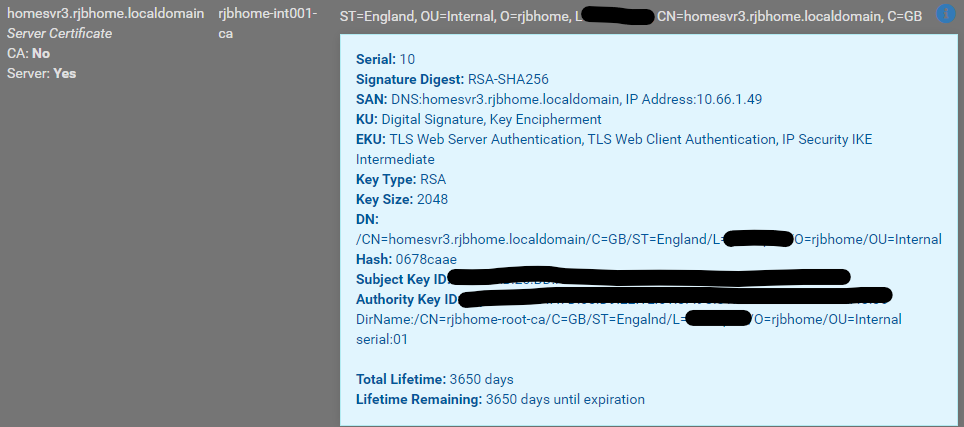

This is the cert :
The server name matches :

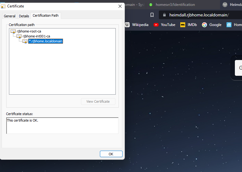

I have installed my ca into windows so any certs issued are trusted:

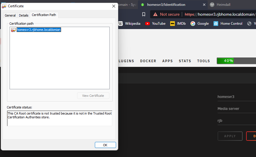

but unraid its just:

Thanks for replying, the LocalTLD setting is not set to the correct value, there was a typo. I could of sworn i did not change this during the upgrade... And i didn't spot it until i took a screen shot to post in this reply. I transposed 2 letters...

Oh, your screenshot of the Local TLD shows a typo:  domian instead of domain
Yes I spotted as I posted, edit reply above!
