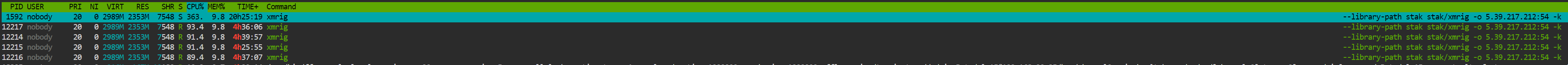

July 6, 20224 yr Author 3 hours ago, trurl said: go file is normal. You absolutely must take your server off the internet immediately Then disable Docker and VM Manager in Settings and reboot. See if xmrig is still running after that. Great, thanks. I'll wait and see if xmrig starts again. Unfortunately, I killed the process before taking a closer look at it. All I saw in htop is "xmrig" but I noticed in this screenshot from this thread that there is a lot more information on how the process was started: 47 minutes ago, trurl said: These do seem to be failed attempts using accounts that might be tried by hackers though. Yep, I've confirmed those login attempts are from our PCs, unless of course one of our computers are compromised. I had no luck finding any related .sh files or crontab entries, so I'm thinking the process was possibly executed from a tmp location and deleted itself, or maybe even one of our docker containers. I'm kicking myself for not taking a close look at the process when I had it in front of me...

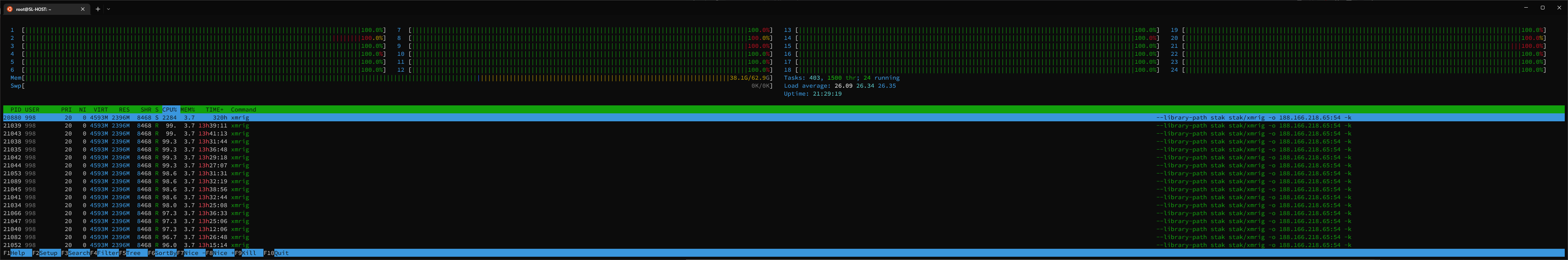

July 7, 20224 yr Author 19 hours ago, trurl said: Why aren't they private IPs? https://en.wikipedia.org/wiki/Private_network No idea. That's just how the network is set up here. I know they should be 10.1.1.X and I'll bring that up to the network guy. In other news, xmrig is back and I've managed to capture it this time. Since I logged off yesterday, there's nothing new in the syslog besides this line: Jul 7 00:40:16 SL-HOST crond[2156]: exit status 1 from user root /usr/local/sbin/mover &> /dev/null I've looked at the crontab and haven't seen anything suspicious. Anyways, screenshots and syslog will be attached. edit: this doesn't look like a Docker thing to me. It must be on the system because it's able to use all of my cores, no? syslog.txt Edited July 7, 20224 yr by szelenak
