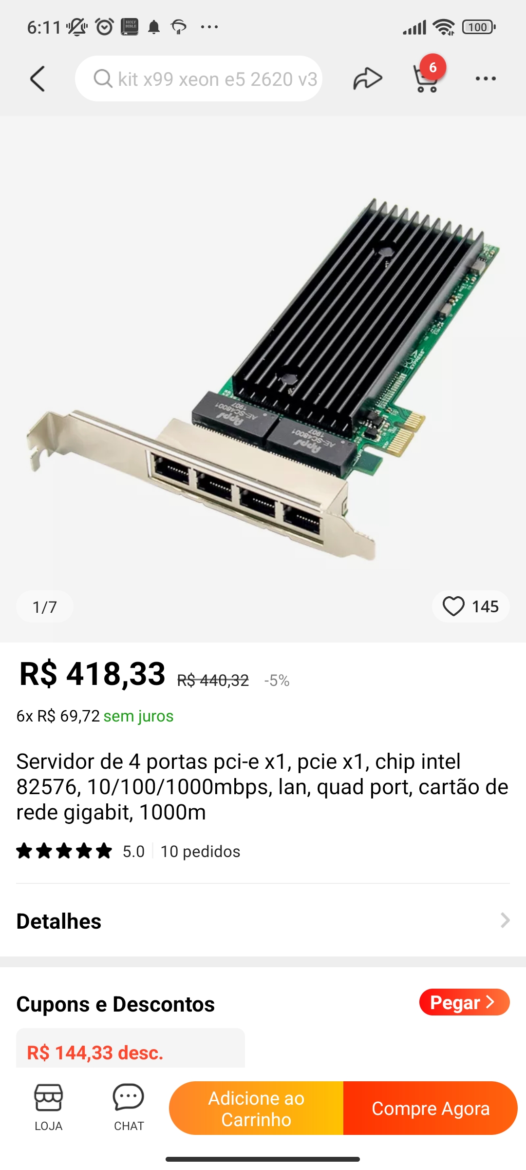

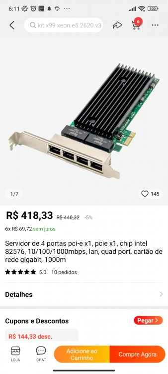

Thanks for replying!
There is 4 lanes like the attached image, try the next link to see info about the product. I was looking for the manufacturer info and found it was discontinued in 2008.
https://a.aliexpress.com/_mMrxRai
I will try what you said later and give the feedback, hope it works.
But, just in case, do you have any suggestions on a more modern one?
About the video card, it's a GTX 1060, I just changed places to try to use the eth card in another pcie lol
the image shows only ONE (PCIe) lane (but FOUR Ethernet ports), so it should work in ANY slot.
I'm not sure if the current kernel still ships with a drive for such an old an special card... But at least, it SHOULD show up in the devices list at boot time.
Take a closer look, this is a quite long and heavy card but only in a 1x Slot. There are often mechanical problems with this combinations. So watch carefully if the card is fully plugged in and does fit into the slot straightly and completely.
