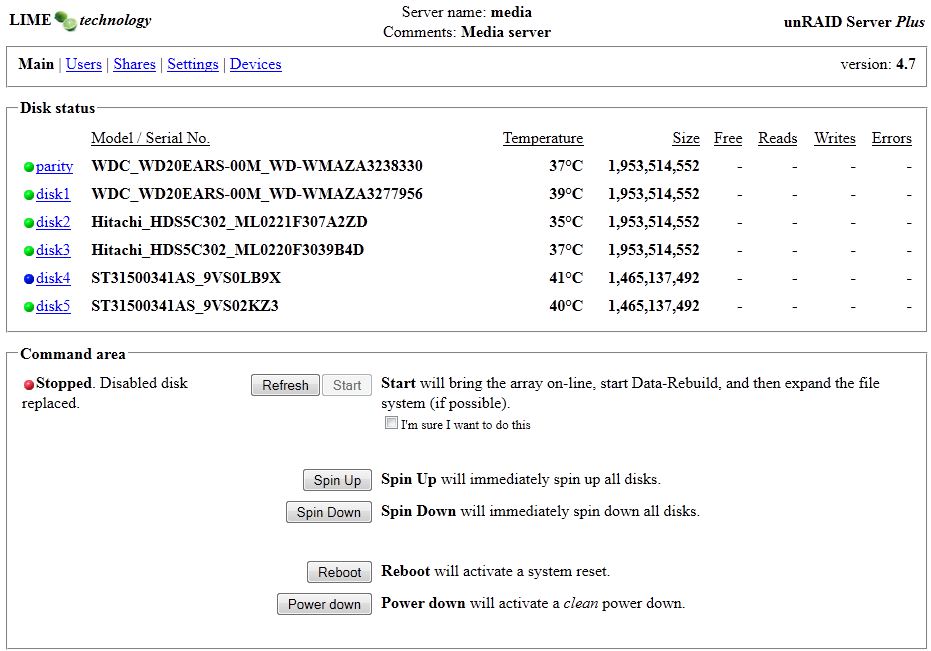

But before this problem started I had noticed I had a disk that was disabled (red).  I had taken down the array and then ran a long SMART check on the drive and it came up fine.  I also put it in my Windows system and used rfstool to mount it and read it in Windows.  All the data was there and seemed intact.    But I put the drive back into the server and started it up.  And now I have the screen in the attached screengrab.  it says "Disabled disk replaced."
If I select:  "Start will bring the array on-line, start Data-Rebuild, and then expand the file system (if possible).
I'm sure I want to do this"
am I going to loose the data on that drive?  (which is almost 1.5TB of data)
I believe I have the option that I could put it back in my Win7 machine and copy the data to the array if this will in fact erase my data.  But if I don't have to go through that long process, that would be ideal.
Thank you in advance!

It was marked as red when it could not be written.  It is therefore in need of re-construction.  Currently, unRAID is simulating it.  If you start the array now, its contents will be re-constructed onto itself, including whatever could not be written.
Most "write" errors do not go away on their own.  It is often a loose cable, or a drive that is failing, or a bad backplane, or a bad disk controller, and sometimes a power supply not sized with enough capacity.
Only clue is to look in the syslog for the original error, but it is too late for that now since you've rebooted/power cycled.
Start the array, let it re-construct the drive.
Joe L.
Yup, start the rebuild and see what happens. If the disk is truely bad then the rebuild will fail and you'll have to replace the drive and attempt another rebuild.
Peter
Do a parity check after the rebuild to make sure it was successful.

For some reason, unRAID "lost" the drive. So, unRAID thought the drive is gone and went into simulation mode. Then, the drive came back and unRAID then thought it was a new drive to replace the one that was "lost".
