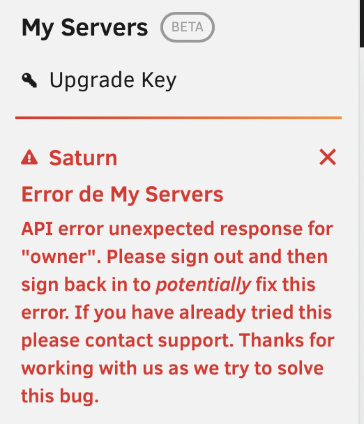

August 7, 20224 yr Hi, I have exactly the same error. I posted in I can acces locally my server and via wireguard von remotely. However, unraid has no internet connection. I cannot update any docker neither plugins. It is annoying to have this behaviour... As you please, we need some help! Thank you.
August 7, 20224 yr Author Solved. The problem was generated by the activation of Wireguard, I have deactivated it and the problem has disappeared. I guess I have something wrong in its configuration.
August 8, 20224 yr Hi @T0rrelles, Nice to heard you have already fixed. Under my point of view, it is quite strange that wireguard vpn affects myservers but you know, everything could be possible. I was able to connect my unaraid server through wireguard. However, I could not surf the internet. In my case, after rebooting my router my unraid server recovered internet connection. I will try to troubleshoot a little more in order to identify the main cause. Cheers,
August 12, 20224 yr On 8/7/2022 at 3:00 PM, T0rrelles said: Solved. The problem was generated by the activation of Wireguard, I have deactivated it and the problem has disappeared. I guess I have something wrong in its configuration. Can you explain this more? What type of WireGuard tunnel was it? Did you use a different url to access the server once the tunnel was up?
August 24, 20224 yr 22 hours ago, oltob said: Hello. I am having exactly same problem, but I have no Wireguard or other VPN. ...and today the problem is gone. I didn't do/fix/change anything. I guess the issue could be external to my server/network.
August 24, 20224 yr Hi, Nice to hear you have fixed the problem. As i have posted in what I realized is that the problem seemed to be in my router. Aftrer rebooting and upgrading firmware, everything worked as usual.
