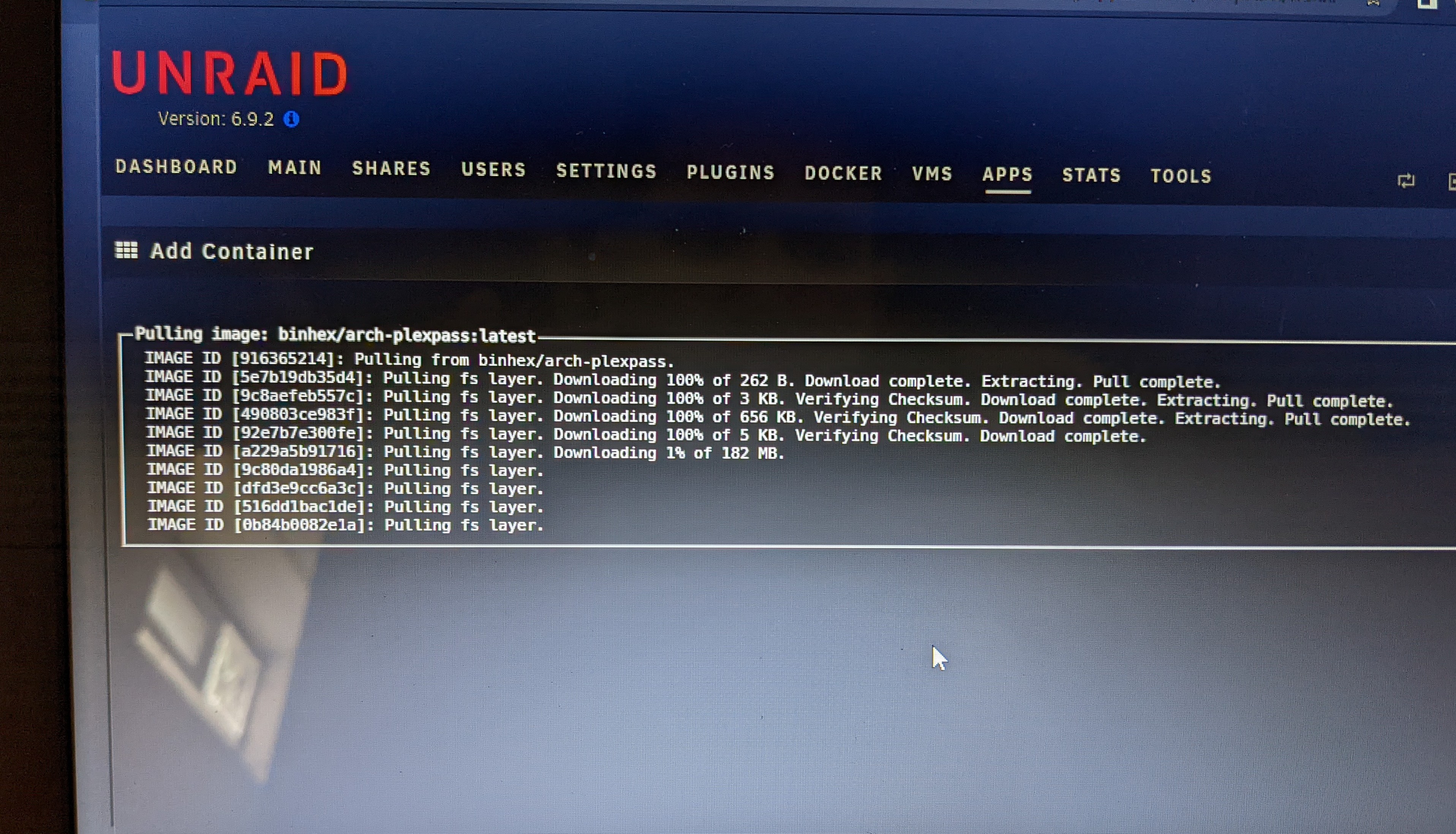

August 8, 20224 yr Community Expert If you can read/write cache, and you recreated docker.img, I don't think the way you got to this point should be a problem. 1 hour ago, Feanux said: Tried to install any Docker container, can't, hangs when pulling images Do you have a screenshot of that?
August 9, 20224 yr Author First, I want to apologize for the picture. I know snipping and ShareX are a thing but at the time the laptop I was on was.... antiquated. It just stays here.
