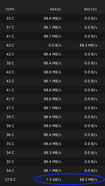

Hi all.
I've recently decided to replace some ageing HDDs (some with many reallocated sectors, and some just smaller/slower drives). I've noticed that each time I replace a disk (or two max at a time), the parity rebuild read speed tops out at a collective 1.5GB/s.
My current setup includes an LSI 9211-8i HBA connected to and a HP SAS Expander using both channels. Build is inside a Norco 4224 case, 5600x CPU, 32gb RAM, Gigabyte X570 UD board with 750W PSU.
Research shows that  SATA 6.0GB/s capable drives operate @ 3Gbps as a result of the HP SAS Expander's limitations, and this is consistent with what I'm seeing in the Disk Identity tab for all drives (i.e.: SATA 3.3, 6.0 Gb/s (current: 3.0 Gb/s)). All drives currently are 8tb <-> 12tb IronWolf flavour. I previously had 2x 8tb WD REDs that could only sync @ 1.5Gb/s, so I replaced them as I suspected it was a firmware issue of sorts and just couldn't be bothered diagnosing why.
During a rebuild, these are the speeds I'm seeing:
My question is, is this collective read speed normal and/or expected? Every time I've done this, read has collectively topped out @ 1.5GB/s. A rebuild of a 10tb drive is currently estimated to take 1 day, 7 hours (initial estimate). Similarly, write speeds are about 85-90MB/s for each drive I replace (160-180MB/s for 2 drives, still 1.5GB/s read speed). I've just got this nagging feeling that the current hardware setup may be limiting the read speeds somehow, possibly the write a little bit also (I've seen some say parity rebuild as fast as ~120 MB/s).
FYI: I was considering replacing the HBA+SAS card with a single, 24 port HBA (something with 6x backplane support) to reduce cable clutter and improve speeds a little, but they're rather expensive right now.
Any insight/commentary would be greatly appreciated, cheers :)

This should give 2.2GB/s, check the LSI link speed, post the output of:
lspci -d 1000: -vv

2 minutes ago, BOGLOAD said:
LnkSta: Speed 5GT/s (ok), Width x4 (downgraded)
It's only linking at x4, than means at theoretical max speed of 2GB/s, about 75% of that is usable, so 1.5GB/s seems about right.
That would probably be it. Thanks @JorgeB. Turns out my motherboard drops from 16x on the PCIE main slot when more devices are added down to 8x/4x/4x (my GPU is sitting in the 8x slot). This post here suggests the behaviour:
Shame, might have to replace the actual motherboard to get an improvement.
