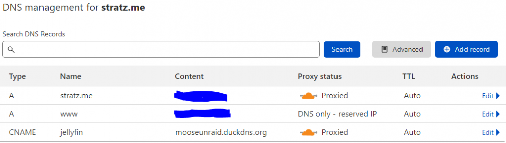

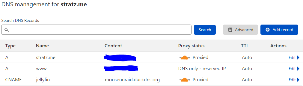

1. My DNS records are shown below:
The 1st A record points to my public IP and the 2nd points to the local IP of my unraid server, then I have a CNAME for my jellyfin docker that points to a duckdns domain, which points to my public IP. Could someone tell me if this is correct?

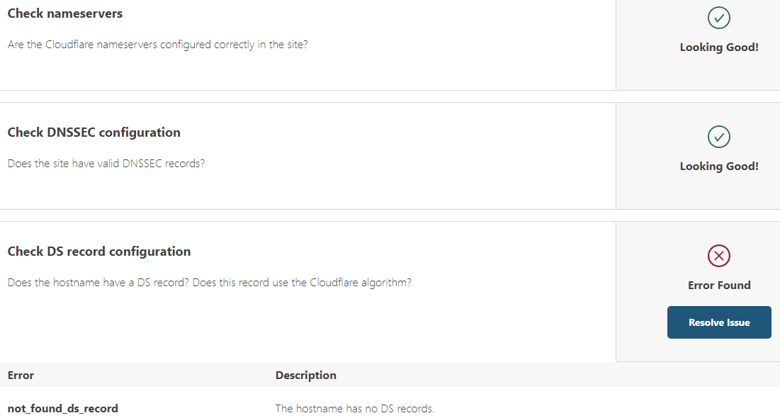

Lastly, here are my results when testing my URL on the cloudflare diagnostics center.
DNS results:

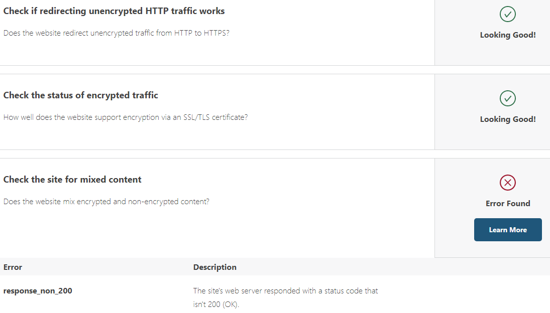

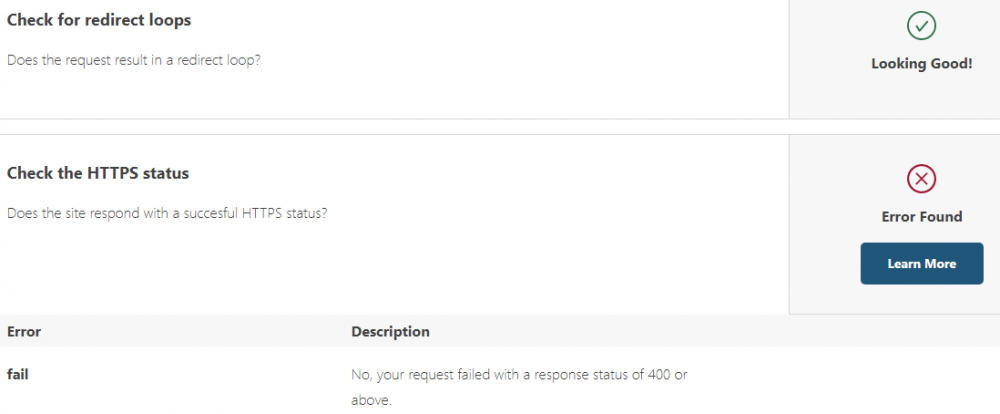

HTTP results:
SSL results:
