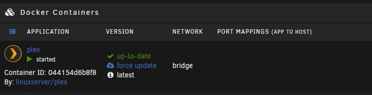

Hello,
Apologies for the big post, attempting to include as much info from the get go for those who may be inclined to assist.
I am helping a friend out trying to resolve why his plex docker does not display the port mappings, like so.

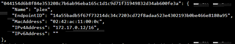

However when running 'docker network inspect bridge' there is an IP assigned.

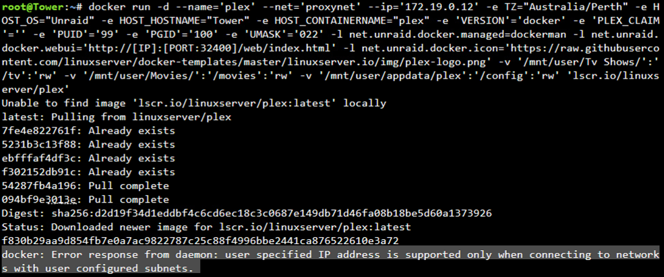

docker run -d --name='plex' --net='Bridge' -e TZ="Australia/Perth" -e HOST_OS="Unraid" -e HOST_HOSTNAME="Tower" -e HOST_CONTAINERNAME="plex" -e 'VERSION'='docker' -e 'PLEX_CLAIM'='' -e 'PUID'='99' -e 'PGID'='100' -e 'UMASK'='022' -l net.unraid.docker.managed=dockerman -l net.unraid.docker.webui='http://[IP]:[PORT:32400]/web/index.html' -l net.unraid.docker.icon='https://raw.githubusercontent.com/linuxserver/docker-templates/master/linuxserver.io/img/plex-logo.png' -v '/mnt/user/Tv Shows/':'/tv':'rw' -v '/mnt/user/Movies/':'/movies':'rw' -v '/mnt/user/appdata/plex':'/config':'rw' 'linuxserver/plex'

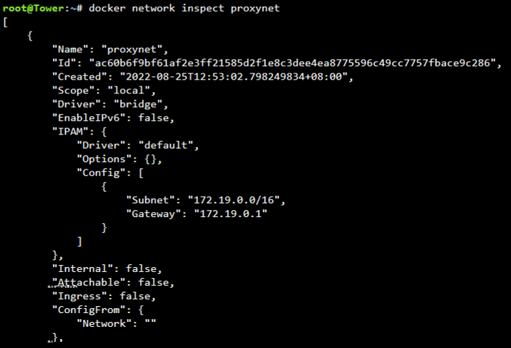

I then attempted adding to a custom network with IP but was greeted with en error: "docker: Error response from daemon: user specified IP address is supported only when connecting to networks with user configured subnets."
I confirmed the network name and network segments were correct. But that is the stretch of my so called "investigation". Please forgive my lack of knowledge.

Why are you running Plex as Bridge network type?  It's designed to be run as Host, and there are no ports in the default template because of this fact despite that Plex uses ~10 ports.
Similarly, the dockerfile doesn't export any ports so as far as any system is concerned there's nothing to be shown because there are no ports exposed anywhere without explicitly specifying them in the template.

Thanks for the reply Squid. Gave me a lightbulb moment, we confirmed that for an unknown reason the Ports were removed from the docker. We tried versions from binhex and linux but same end result, we downloading the docker the ports were not pre configured. So we manually created new ones based off my install and this has worked. Simple really and cannot believe I missed something so basic.
To answer why Bridge? Bridge, Host, and custom proxynet all produced the same result, which I know understand why and can absolutely slap myself for.
